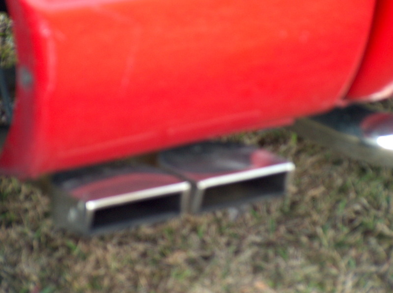

Here's one on a member's truck I've done a ton of work on. Cherry Bomb Extreme out the side to dual Gibson tips. Ain't seen this sucker post in over a year now, dunno if he still has the truck or not...

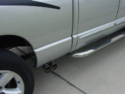

I just did mine yesterday!
Had a magnaflow for about 5 months and wanted a little more growl so I eliminated the rear resonator and tail pipe and gave it this custom look.
Sounds nice now and costs way less than if I bought a complete catback system.
