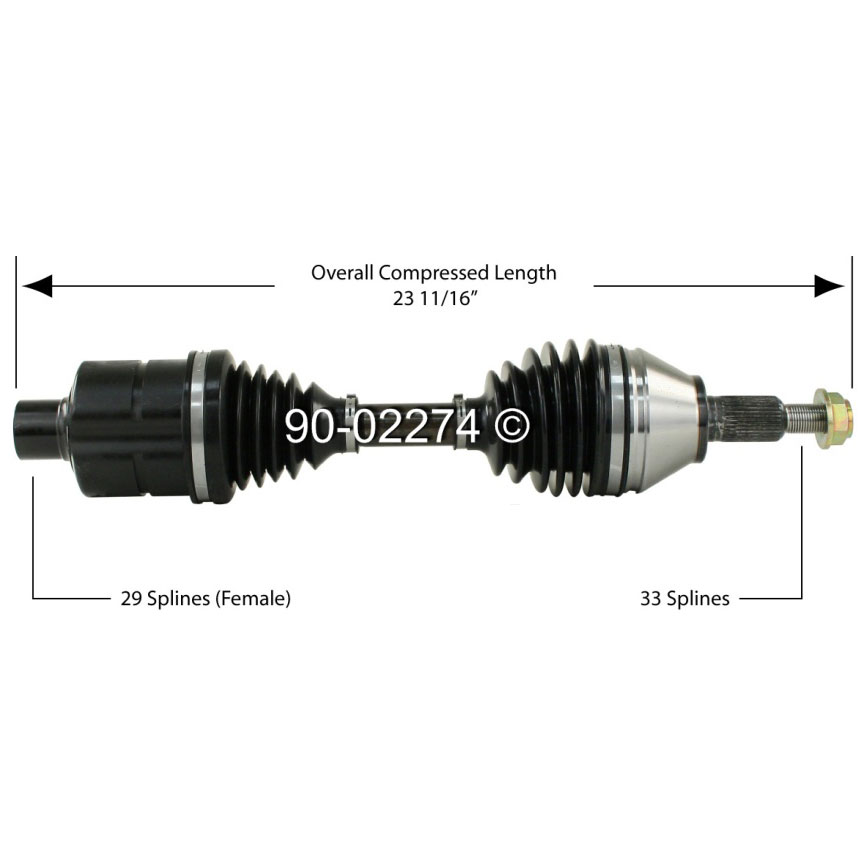

Not the drive axles, the boot on the actual front propeller shaft
Old Mar 7, 2012 | 10:33 AM
Dead2Fall's Avatar
Dead2Fall
Joined: Mar 2012
Posts: 524
From: New Jersey
NOT this!!

My bad, I read your initial post WAY too fast...
