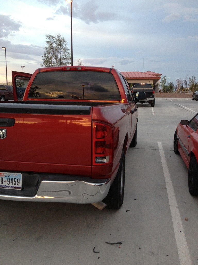

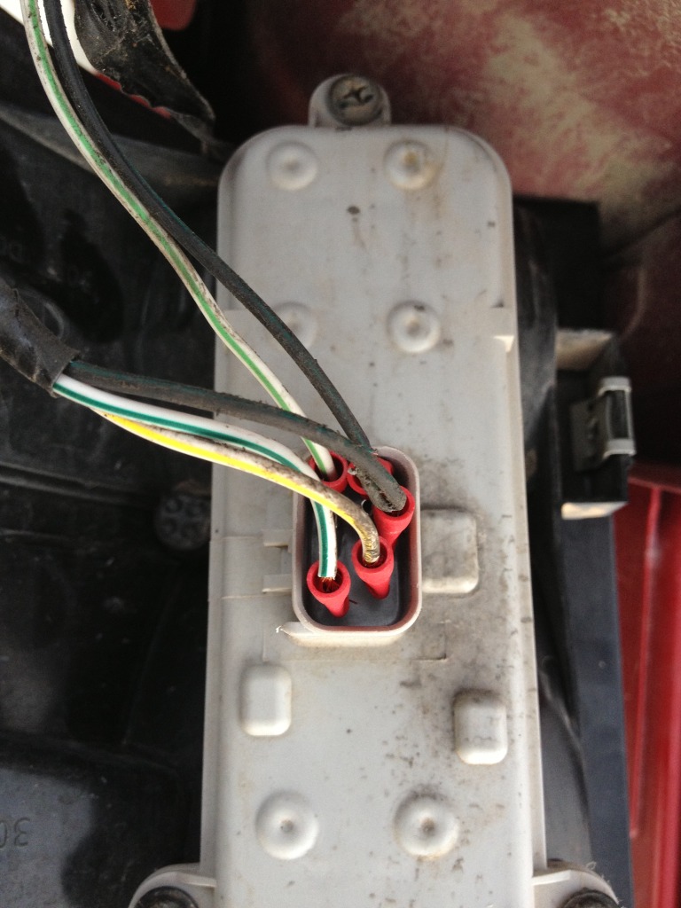

so i posted an ad on craigslist for a bunch of random parts over the past years ive replaced on my truck. one of those items were my 06 tail lights. well i got a reply today asking how much if i installed them and when i could do it. i kno how hard it is to sell stock parts and told him only $50. my thought on the year difference was well theyre probably the same connection. i was wrong lol i had to cut his old light harness and do little single connectors and have him hit the different things to test them, a five minute job turned into an hour. so it all works perfect, reverse, brake, turn and 4way. in fact the top and middle lights go on for brake turn and 4way when used. couldnt get it to work anyway so hey its custom.
wiringfor anyones else wanting to do this

how it looks now, an 07 with o6 tail lights

Yea the wiring changed in 07 which is why the lights are different in general
