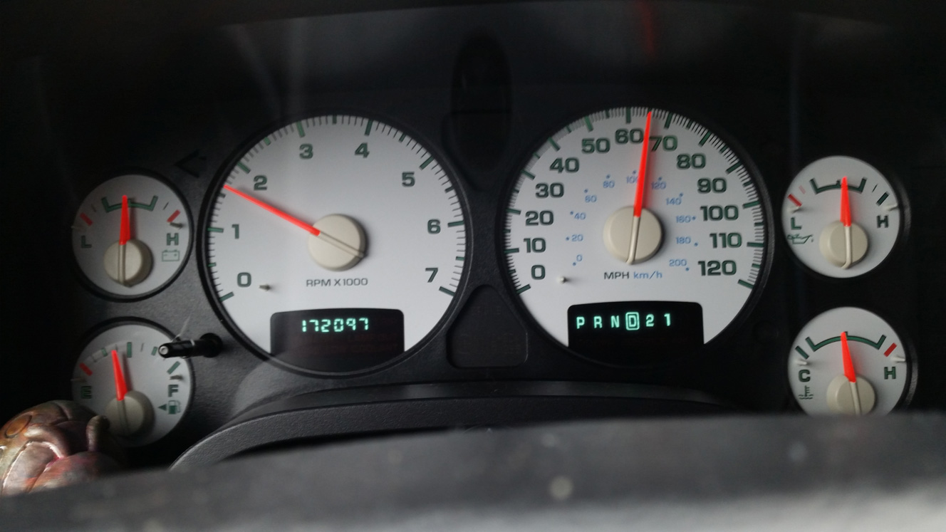

Whats even nicer is the 5th gear! Here's a couple pics.
Previously @ 65 I was around 1800 RPM
Previously @ 70 I was around 2000 RPM
That's some real results right there.
