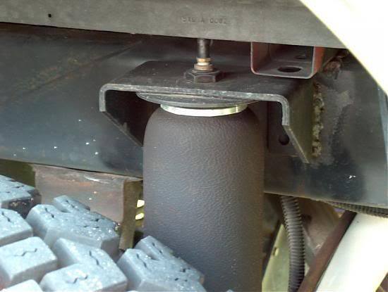

Just buy firestone ride rite air bags. You can set them anywhere from 5psi-100psi. I can load my whole 25ft toy hauler with a 1000lb tongue weight and have it sit at stock height. You don't need on board air. Just run your Schrader valves to you back bumper. I've used a bicycle pump to pump them up before.

^^^ Air Bags, best thing I've ever done. Under $300 too.

Air bags... been using them since 1970.... air up "Loaded".. air down "stock ride".

Thanks everyone. I think I will be going with the airbags. I think that will be the best option for me.

I installed Air Lifts on my '04 Ram way back in late 2005. When I sold the truck at the end of last summer they stilled worked like the day I installed them.
BAG IT...
