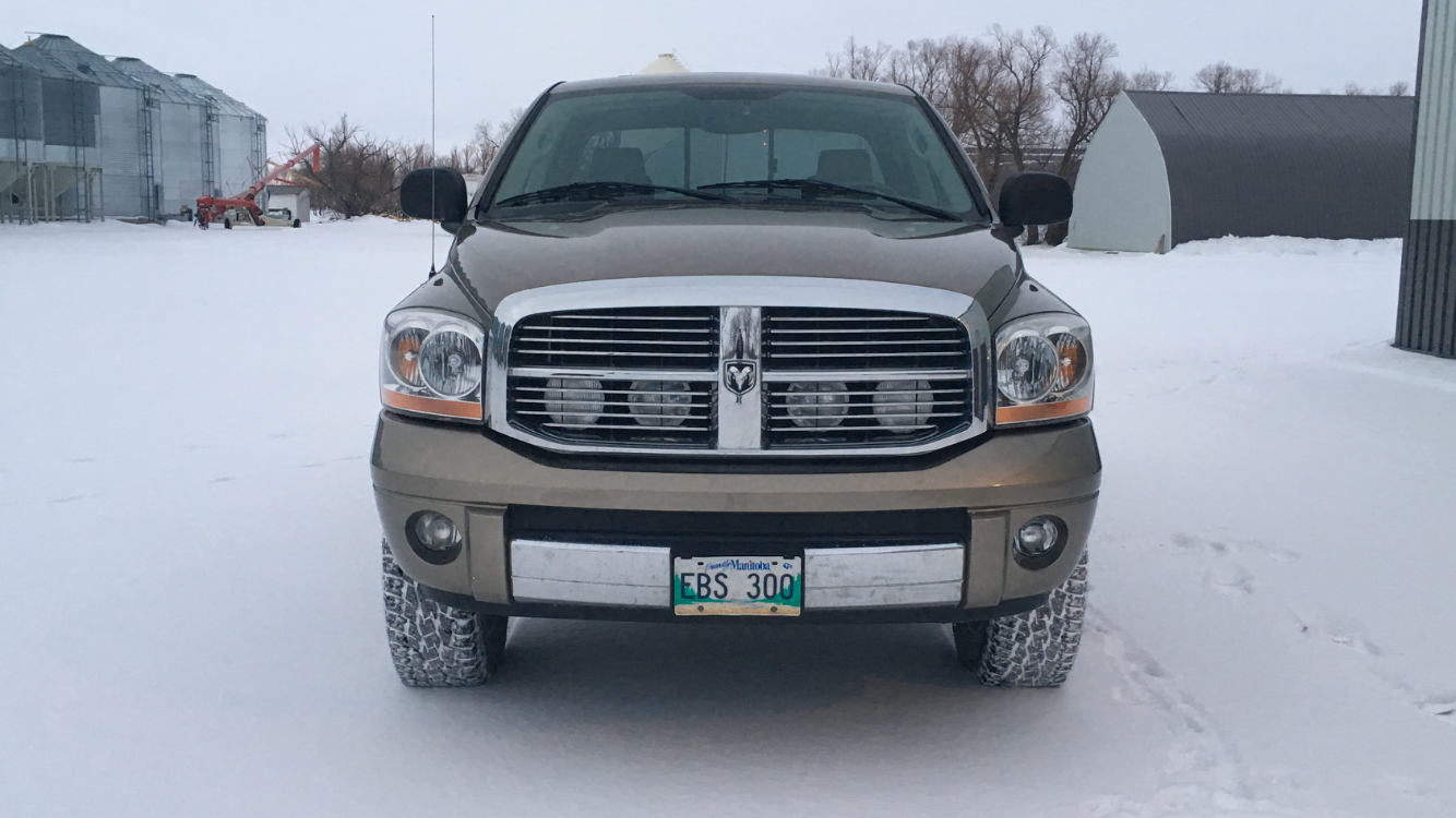

I haven't been around here much recently, but did some searching before I did some work to my truck. I figured I should post some results (mostly in picture form) for others considering the same.
I put the hella 500's in the grill over a year ago, they work really well. The outside 2 are the fogs, the inside 2 are the driving ones. I wired them through two relays using the factory fog switch (so when I turn the fogs on, they come on as well)
Recently I put on 275/65r20 Toyo AT2's on the factory 20" rims. I changed from a HBS level kit to Bilstein 5100's (at the highest setting), and changed all the ball joints as well as the axle stub shafts and half shafts to try get rid of the vibration in 4wd. (Which I still have some, but it seems better) I also put on Monroe's load adjusting shocks in the rear which gave me an inch or so of lift in the back. It is sitting on level concrete in the picture.
Hopefully the pictures can help others considering their options!

looking good sir!

Nice. I like the idea of extra driving lights with the fogs.

Nice work! Looks great!
