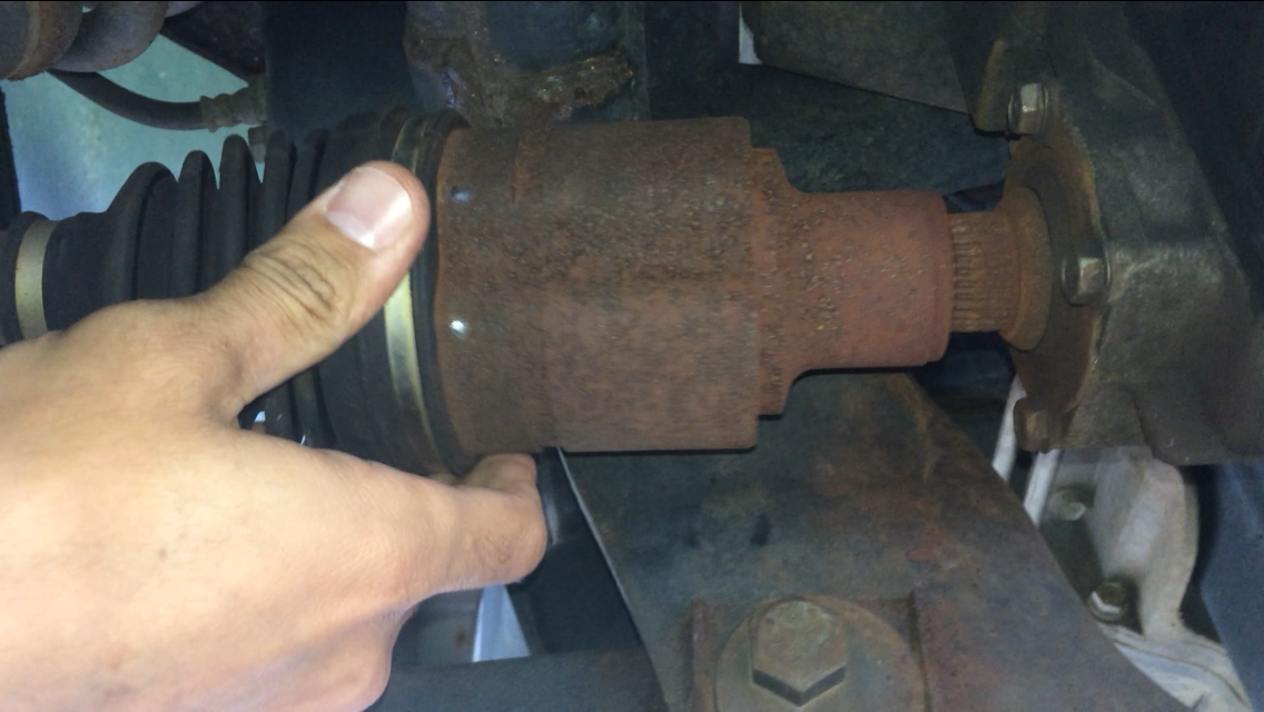

I can say that I had been tracing a vibration for months. I balanced tires, replaced tires, u joints, brakes all around and still no change. I checked the rims for roundness and trueness and checked the run out on the driveshaft all with no alarming results. The vibration was more of a wobble and it was bad. I finally decided to quit and take it to a shop. They had it for a day or so, checked all the things I already looked at and was returned to me wobbling just the way they got it. He couldn't find the problem. So a few days later I'm at it again and jack the truck up AGAIN and continue to touch anything that rotates. Because the vibration was in my seat I stayed looking at the rear of the truck, so I figure I'll check up front. I begin spinning the front wheels by hand and they look fine. Axles look good UNTIL I touch it with my hand. The right front CV axle almost slides off the shaft. So I order a new cv axle and since the shaft got worn down I pulled the shaft which comes out easy from the outside of the differential and replaced the output shaft and seal. Proud to say problem solved.

The CV axle shaft slides over the output shaft and is supposed to be held with a c clip. The C clip is internal to the connection though. You don't see the clip from the outside until it's disassembled. It shouldn't have much play in it. When I touched mine it nearly fell off. If you have anything leaking while you're there then now is the time to replace the seal too.
