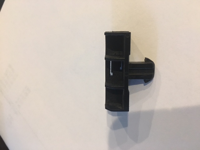

I just fixed mine today. After a good rain floor mat was wet, look under dash could see water dripping off HVAC case. After using the water hose and spending 3 hours I found that there is a black clip at the bottom of the windshield on the passenger side. I believe it there to align the windshield when installing a new one. Anyway it looked ok. But when I pulled it out you could see the rubber gasket under it had failed. Also the bottom of the clip has a slight groove in it that helps channel the water inside. I popped it out cleaned it up put some silicone on it and reinstalled it
On the driver side there is also a clip but it has no gasket because the hole does not go in to the interior.
So you only have to check the passenger side one. I would just pull it out and reseal the passenger side one. You really cant tell its not sealing by looking at it.
I'll attach some photos
Hope this helps
