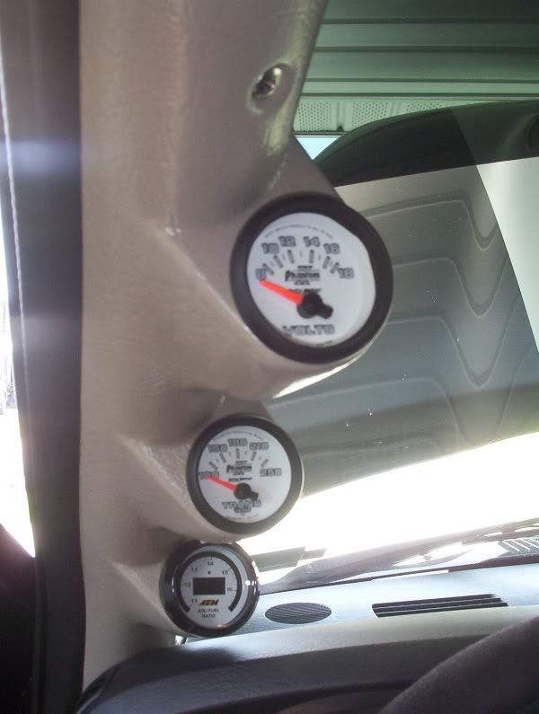

Just get the gauge/sender and then I used this manifold from Summit to splice into the pressure line.
http://store.summitracing.com/partdetail.asp?autofilter=1∂=ATM%2D2286&N=70 0+400442+115&autoview=sku

Nice setup, Helo.
I have the single gauge pillar sitting in the garage, in the box still. I optedfor the single so I'd still have the grab handle. Instead of goingto the tranny though, I'm thinking of getting the Magtec rear diff cover and plugging in there to monitor rear diff oil temp. SinceI sold my bass boat I don't tow much anymore...
