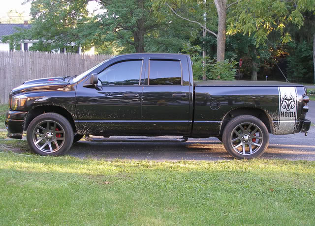

I have a 07 with a leveling kit. (2" drop in the rear to level it) Here is a picture with 305/45/22's which are 12" wide and 32.8" high. I have to run 1/4" spacers so they dont rub.
