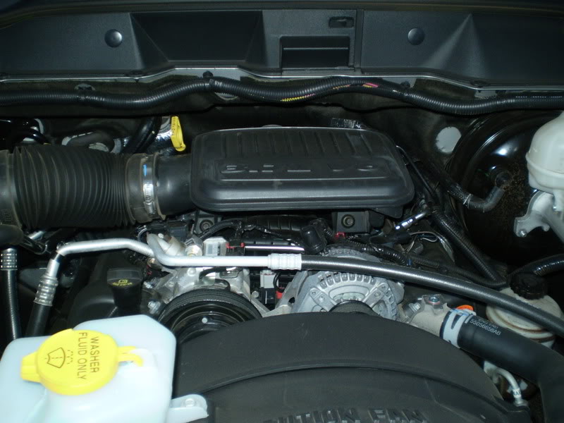

did yours look like this before you took your box off, and do you think it made a difference going strait to the throttle body, instead of the box

The key item to know about V6 air intakes
is that with their smaller cubic inch displacement
they have even less need for lower restriction
at higher rpm and full throttle.
You can find this out for yourself
by measuring the IAT sensor and MAP sensor
before and after a CAI install
and then can send the CAI back for a refund
...unless you are really after more noise
and a flashy look that impresses only those who don't understand engines
