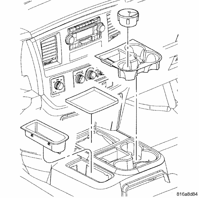

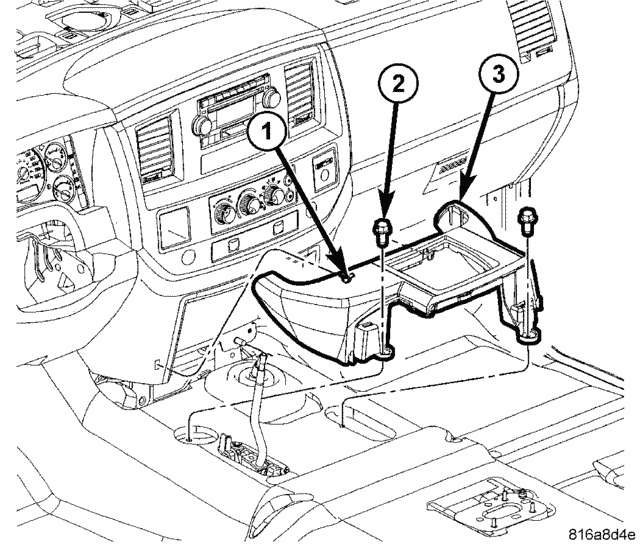

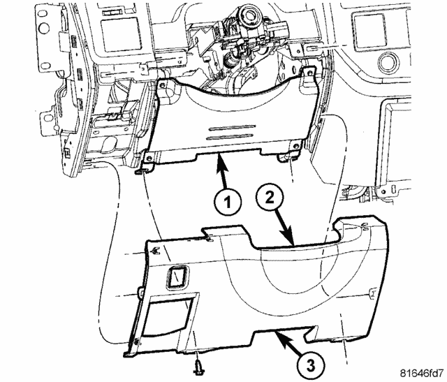

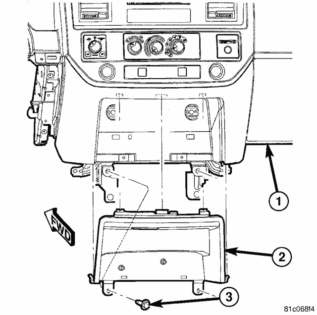

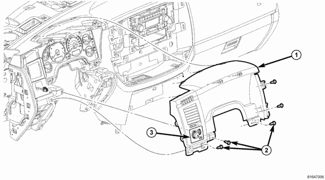

i got the OEM fogs any they came with the OEM switch, so i have to open up my dash to swap out the old light control unit.
HOW DOES THE DASH OPEN?!?!? i tried just playing with it a little bit, and that sucker is on there good! what's the secret?
also, the directions say that after install it has to be hooked up to a computer for recognition, will only a dealer have this, or do most mechanics have one?
Old Jan 30, 2008 | 10:24 PM
Parts/Service's Avatar
Parts/Service
Joined: Mar 2004
Posts: 2,703
From: Bremen, GA.
Default RE: Opening Dash on 2006
Follow the pics. There is an easier way, but it would be easier if you call me and let me explain....DAVID
