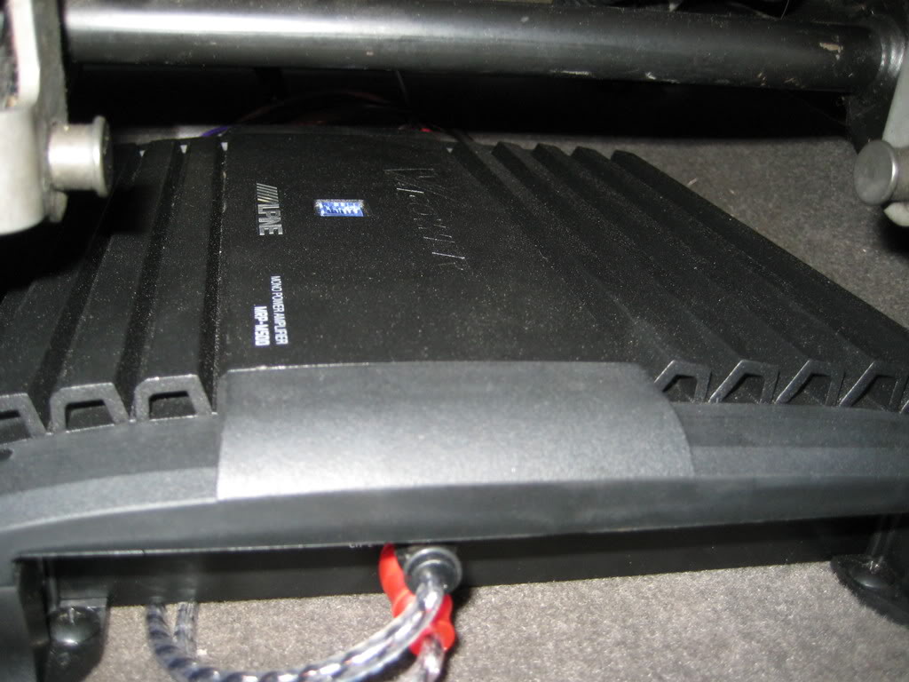

Some teaser pics of test-fitting the top-mounting depth of the subwoofers and subwoofer amp for the setup I'm planning to build:
Damn that amp is massive. Heres my 12" type r and alpine amp.
