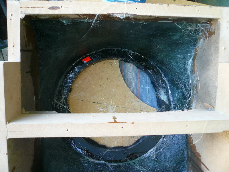

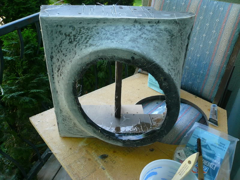

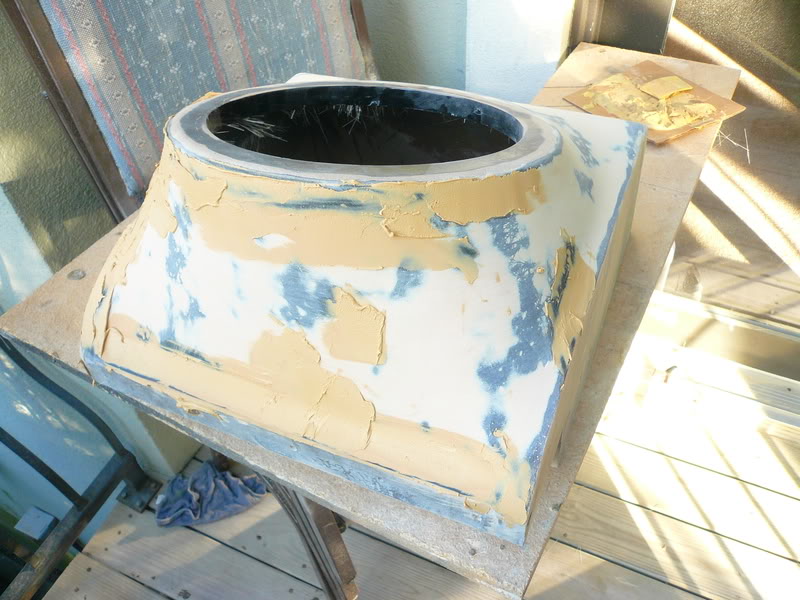

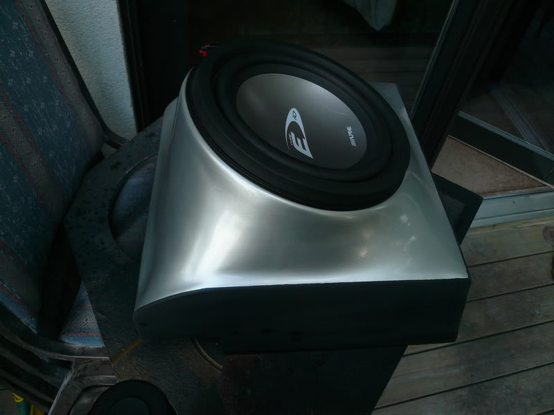

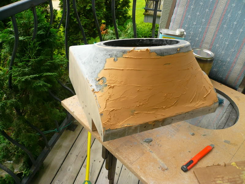

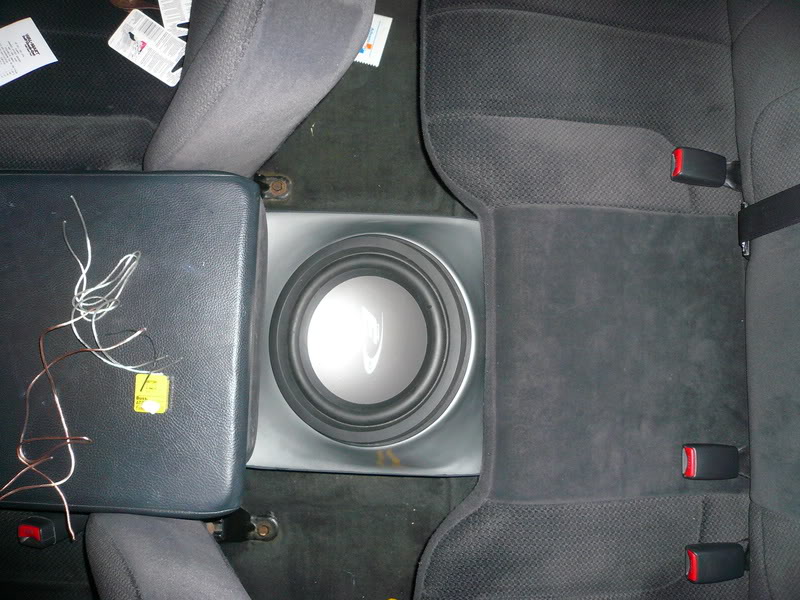

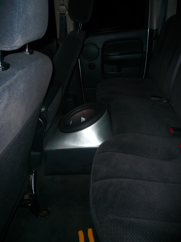

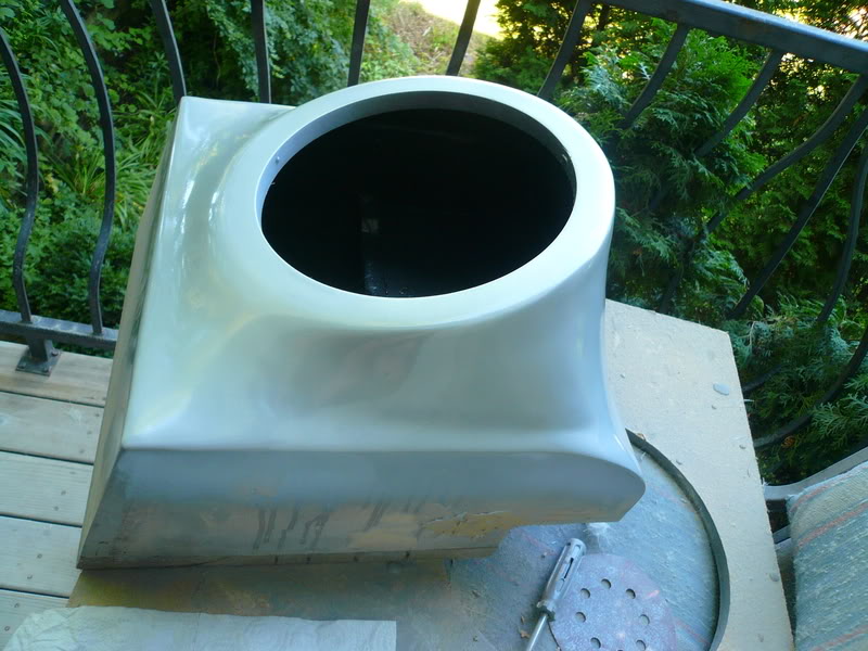

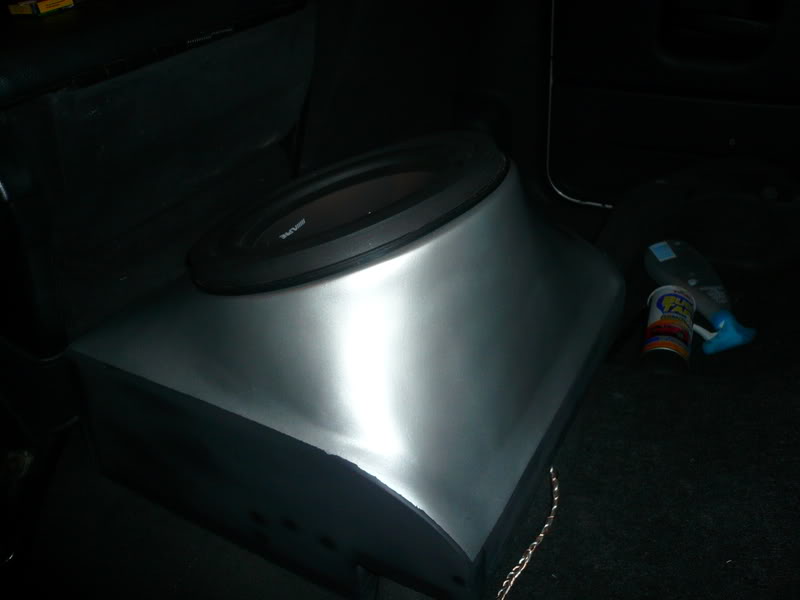

i got bored the other day and decided to throw a single 10 in my quad cab. didn't want to do the normal, under the seat setup, so i mounted it in between the front and rear seats. the front armrest still folds all the way forward. it's exactly .9 cu ft. bottom is made of 3/4" MDF and with 5 layers of glass on it. it's not perfect, but i ran out of time to finish smoothing the surface... it'll be refinished in a couple of weeks when i have time. the top is colormatched to the exterior color of the truck and the bottom is sprayed with bedliner.
everything was made using just an 18v jigsaw, 18v drill, and an 18v da sander.
this is the first sub box i built using glass, all the rest in the past were made of MDF and in my garage back in NC where i have a full wood working station. I'd say it's not bad for 2 days with barely any tools.
here are the pictures.

good work! thats exactly where my box is. i custom built mine as well, but mines not painted, its covered in black diamond plate
how did you get the perfect shape? like roundness for the sub and all that?
a lot of hand sanding... roughly 5 hours shaping it the way i wanted. i jumped on it to make sure it was strong enough too
