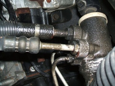

Well, after going through all of these power steering fluid leak threads, I see I'm not alone. I'm glad I found this place. I had my truck in for tranny and rear differential service last week. They call me from the dealership and claim I have a bad power steering hose and they would replace it for $220 plus tax. This was a surprise. I just changed the oil myself 3 days earlier. Did not notice any fluid leakage from the power steering hose/rack/reservoir area and did not and never have had any drippage on my shop floor. Being leery, I told my trustworthy dealer negatory on the power steering hose change. Figured I check this out myself. Next evening, I have some drippage on the concrete floor and look up underneath at the power steering area and see leakage. It appears to be coming from the hose connecting the cooler to the steering gear, with the leak at the hose connection to the steering gear. At this connection there is not a "pinch" clamp as there is on the other 3 ends. There appears to be some kind of fastener band/clamp that I'm not familiar with and not sure if it even is a fastener. Prior to finding this excellent forum, I conversed with a knowledgeable guy on another one and this is what he told me about the connection in question:

Thanks for the replies. After taking a better look at the power steering hose connection in question, I see the clamp/band on this end of the hose is a 1-Ear clamp (see pictures). The other 3 hose clamps are spring clamps (I called them "pinch" clamps in my original post). I'm going to put screw/band-worm gear style clamps at all 4 connections and see what happens. The replacing of the "threaded fitting" was throwing me off before (which isn't hard to do), but I think I follow what the guy was referring to now. I will let all know if the new clamps work after giving it a week or so.

It's been almost 2 weeks and I'm pleased to say the 5/16" screwband wire clamps I installed are working. No sign of any leakage/drippage. I purchased 4 of these clamps at the Ace hardware store for about $3.50. The dealership wanted to charge me $230 to replace the hoses/fluid. The hose kit itself was going to be $40 plus cost of new fluid to replace myself.
