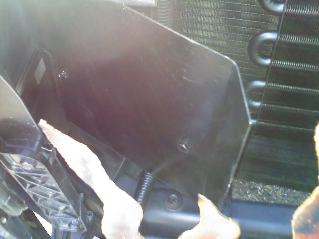

I fabricated my own from a sheet of alum for about 5 bucks and again it is just directing cooler air toward the cai. I did not think it had a $40 benefit but for 5 and about 30 min of my time i figured what the hell!!

yeah shark, after I get off work and get near my ram I will take some and post them tonight, it was really very easy, I started with a pc of 12"x12" black aluminum from hardware store, cut it down to 9x9 one bend and screwed it to support post behind headlight. I also put a flat bracket in the center behind it for support since the alum is not that rigid.

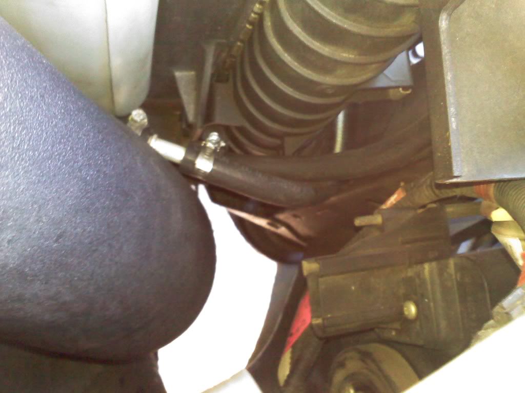

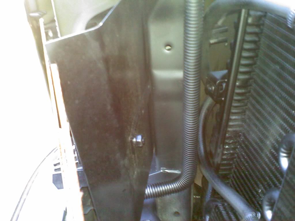

ok hear is the scoop i made with a small pc of alum
