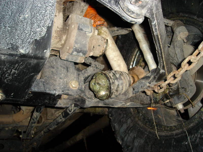

The shop owner called me today and told me both my front CV boots were not just cracked/torn, but nearly gone completely. Is it normal for a 6" lift to put that extreme of an angle on the boots that it causes them to fail prematurely? The truck has 23k miles on it, and the lift has been on for 20k miles. Anywho, gettin the CV joints both replaced for an additional $100 for parts/labor...cant wait to get it back tomorrow

yes, very normal. 6" is too severe for anything but looks. Seen many a CV go kablooey off road and it's always the 6" suspension lift guys, usually running 37s, but not always.
The proper way to keep the angle and still get the height would be a 4" suspension lift then a body lift... By the way, AF, how'd the header install go?

btw... are those your cv joints hammer?? what the heck did you do??
