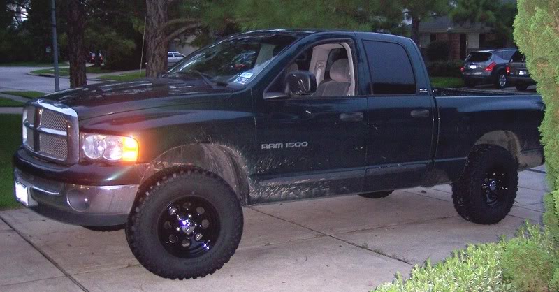

I've got an 02 1500 4x4 with the front leveled and bfg mud terrains 35x12.5r17 with these wheels from summit racing p/n: CRR-3978955.
Fits perfectly with no rubbing and no other modifications.

alright thats what i thought but they were dead set on me not being able to do it with out some bending they said that with the 12.5 wide that it actually comes out to like 13 something wide and it will rub but this helps out and nice its good to see a quality pic of the tire ratio i was looking for
