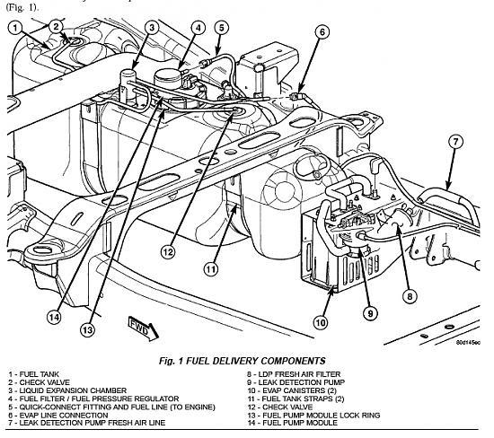

I just posted this a day or two ago, but was too lazy to look for it. Check the entire system, you'll find a small leak somewhere...
