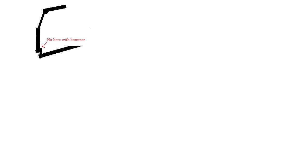

to separate the ball joint hit the spindle with a hammer like the pic i attached(right where the ball joint enters the spindle) and you can just beat the joint out of the control arm with a hammer as well. the ball joint press does help but its not a hundred percent nessasary
