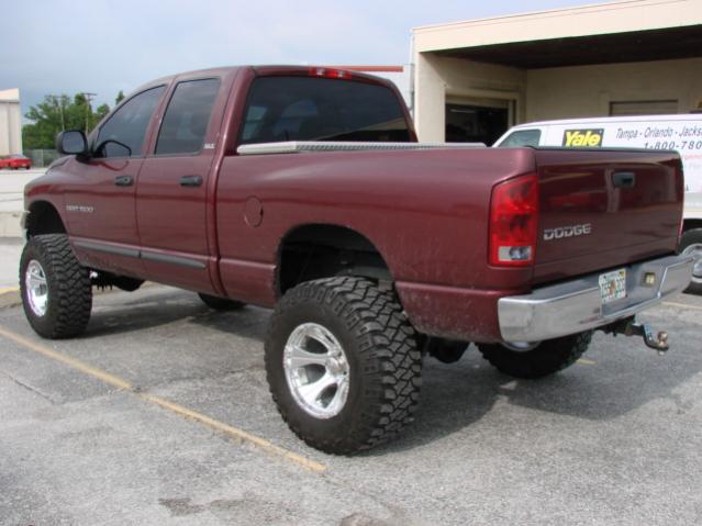

I put a high pinion dana 44 under the front of my 2wd truck. I used a seperate 205 transfer case. I used a 5 lug setup froma 70's model F-150. I can send some pictures if you would like? The fram on the 2wd is the same as the 4wd and it was not hard to do just took a solid week of doing the work and about 5 months of gathering parts. I used a steering gear box out of a Jeep grand cherokee form the junk yard. email me if you want pictures.

here are a few pictures of the truck.Ram 1500 solid axle conversion! HELP-mark-s-mini-truck-001.jpg

Snap. It seems the guys with the coolest stuff just go out and do it...screw forums
On a side note, how well does that truck stop? Those front discs look like they get quite a workout from the wheels/tires/weight of the truck.

I have no problem stopping, it feels real good. These are 37"x13.5 on some 18x12 wheels so they are not too big. There are some guys around my house that have bigger tires on the same front end.
