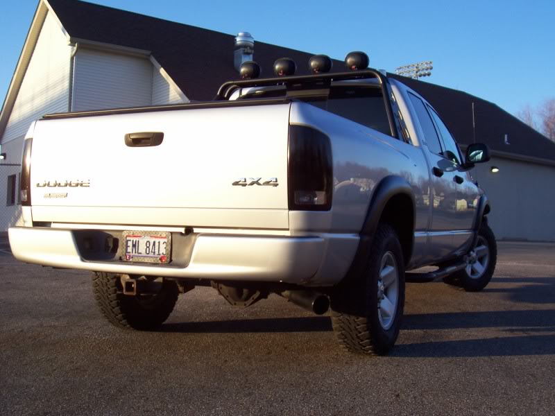

Here is mine, high heat satin black, from autozone w/ an industrial grade clear. Sanded w/ 80 grit then sprayed several coats of black and several very generous coats of clear.

Thanks for the photo I think that is the way I will go, just have to find the right tips.
