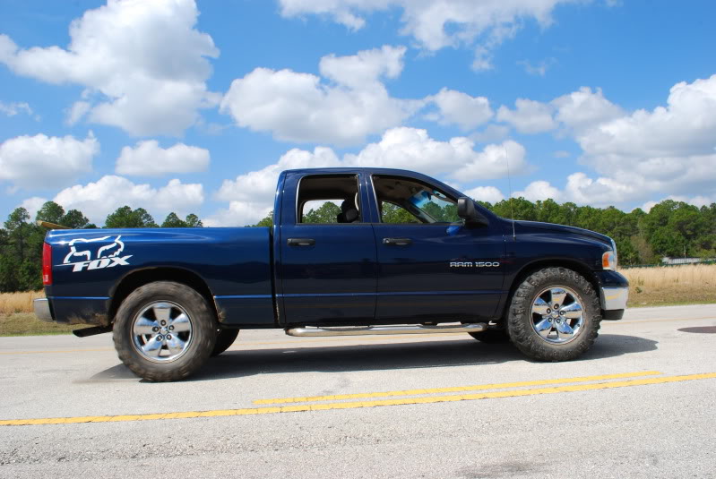

you can always just slap some 36's on and call it a day!Name:  DSC_0366.jpg
