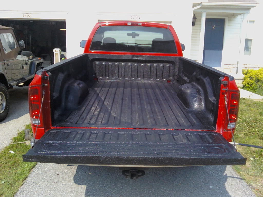

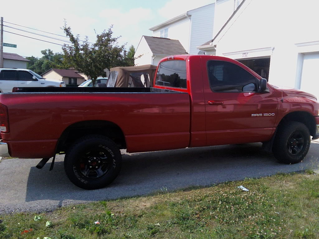

Here are three pics

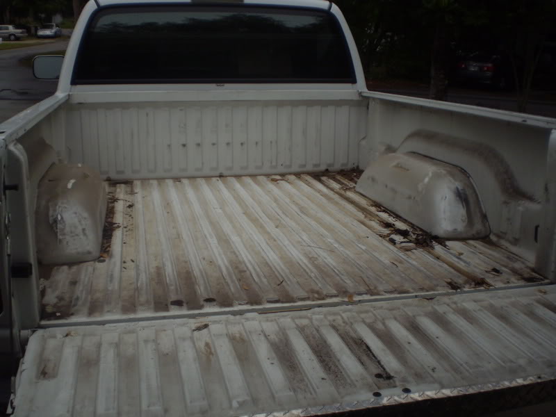

When I ripped out the Drop in, found a few rust spots, and about 10 pounds of dirt.
Had a buddy help me sand it all down.
