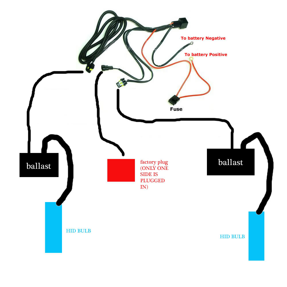

Ive figured most of the problem out, but to make the lights work continuously, i need to use the relay, and to use the relay, i need to fin out where the factory headlight power source is so that i can plug into there, any help?

Here ya go this should help. This is how to wire it up!

Thanks man, afer i get a new fuse ill try wiring it up again
