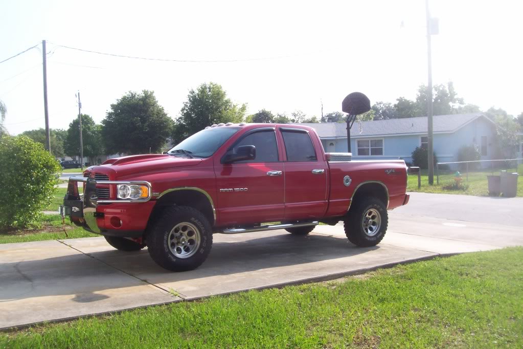

Mine is a stick on SRT type clone, actually bought it as a band aid for a hood mishap. I had a problem with the tape coming up, but it was my fault, they specifically say to do it on a day over 65 degrees and I put mine on at about 50 degrees. The hot summer sun hit the scoop and it expanded a bit and lifted the tape up. I cut the scoop off, cleaned both the truck and scoop with an eraser wheel and applied new 3m tape on a 90 degree day.
Never been an issue since...
