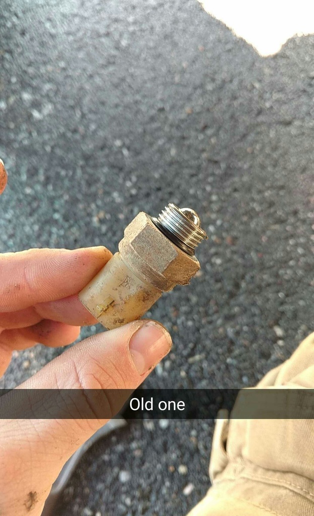

I just did this today actually. 20 min, give or take.
As told by my snapchat:
