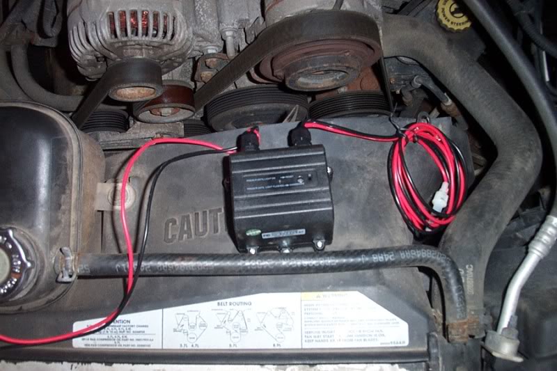

I mounted the compressor to the rear of the stock air filter box.

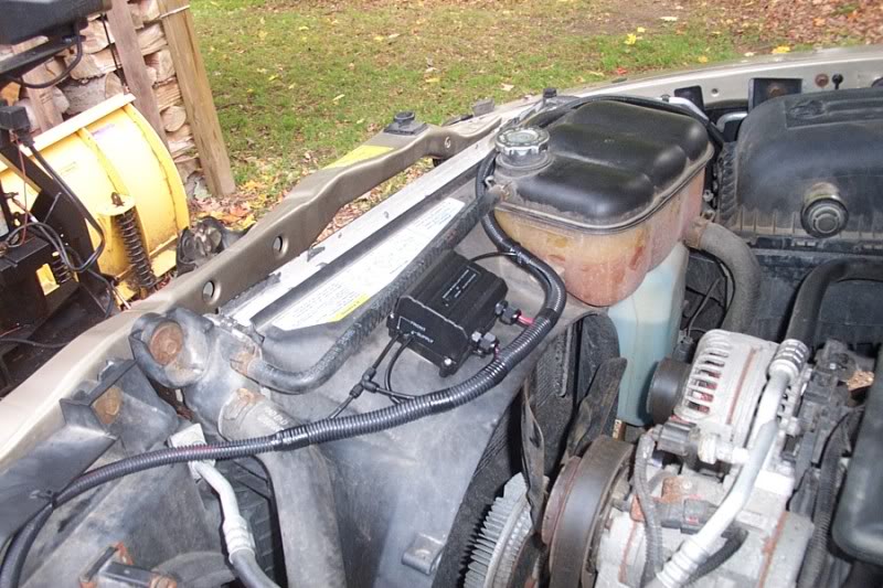

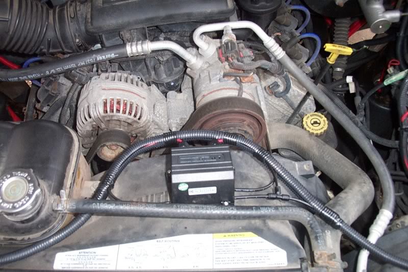

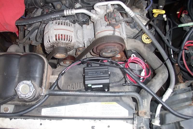

I mounted the receiver on top of the fan shroud.

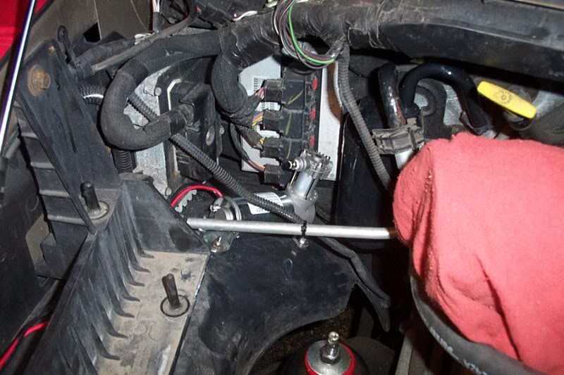

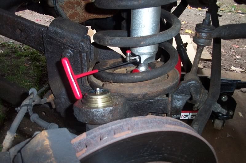

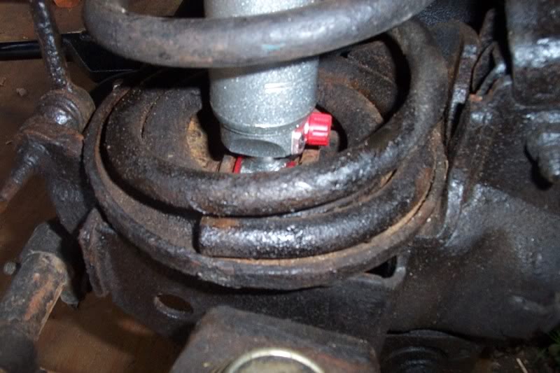

Now it's time to remove the original control **** and replace it with a new 90 degree air line fitting.

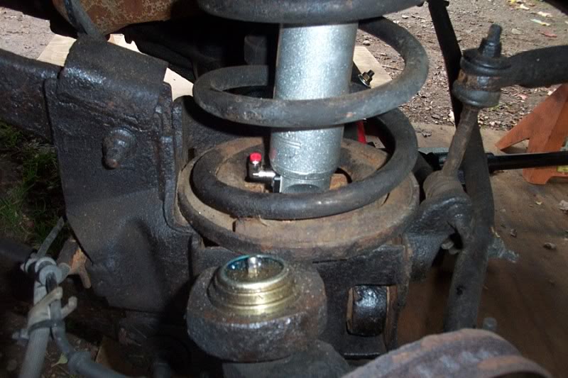

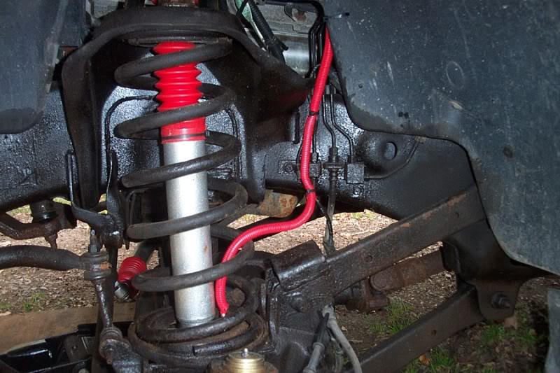

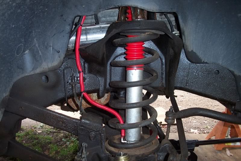

I then ran the airline and wrapped it in some of the split loom.

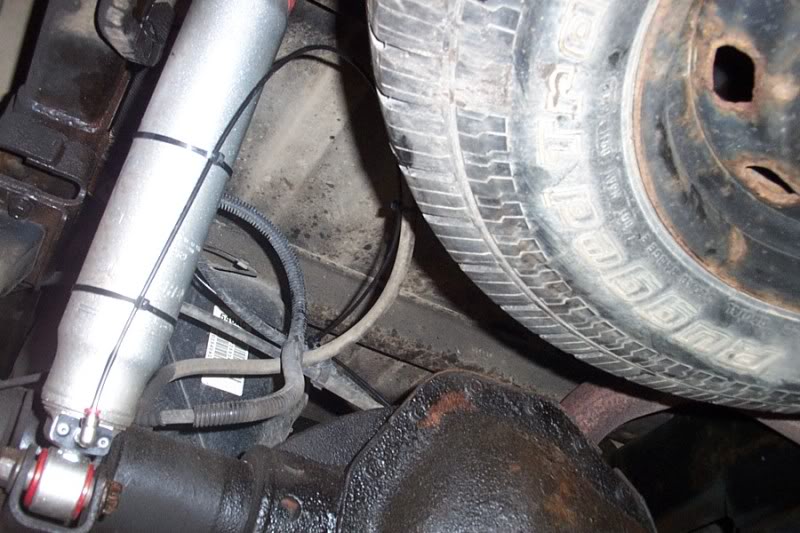

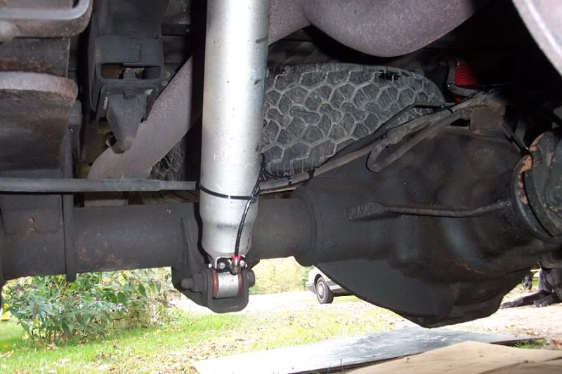

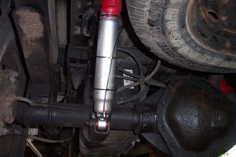

I then ran the rear line. I followed the driver side frame rail and wrapped it in the split loom anywhere there were sharp edges. It was ty-rapped along to keep it in place. I T'd the rear shocks at the top of the rear diff where the ABS sensor wiring is.

Once the key was on I set the different settings and I could hear the compressor kick on or the air leak down if I went to a lower setting.
