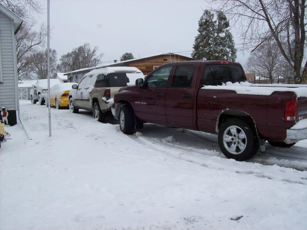

Just as of late I have been having problems. My 2003 Ram 1500 4x4 has just turned 60,000 miles. Everything has been fine till now. Wanting to know if any of you have had similar problems with yours and the fix.
First, right rear brake caliper is now stuck, not the slides, the piston. Got the rotor red hot today, tore it down and found this...had to order one, nobody here locally in central Illinois has one on the shelf.
Second, the heater will not blow on my feet, it will blow out from the dash in your face and defrost only.. anyone got the remedy for this?
Lifters are starting to tick on start up...new lifters needed?
What kinda price are you all paying for the 20 inch tires?
