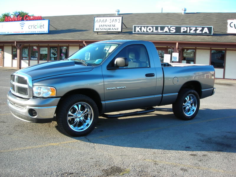

Here's how it sits right now

check out something like this brother.....
http://cgi.ebay.com/ebaymotors/2002-...ewItem?rvr_id=
Old Jan 14, 2010 | 10:47 AM
BadHab1t's Avatar
BadHab1t
Posts: 5,930
From: TAMPA BAY
look here just buy some lowering shackles from moes 60 bucks and your in my truck had that rake and i hated it i bought djm drop shackles off tuned93 on here and i also removed the bottom leaf spring which is the overload spring and i t dropped it another 1/2" drop shackles claim 2" but in actuality its only 1.5" raiderj did a o/l leaf delete just as i have and my truck sits almost perfectly level.....also try reading some of the info in the sticky at the top of the page lots of lowered talk in ther thats what it for......
