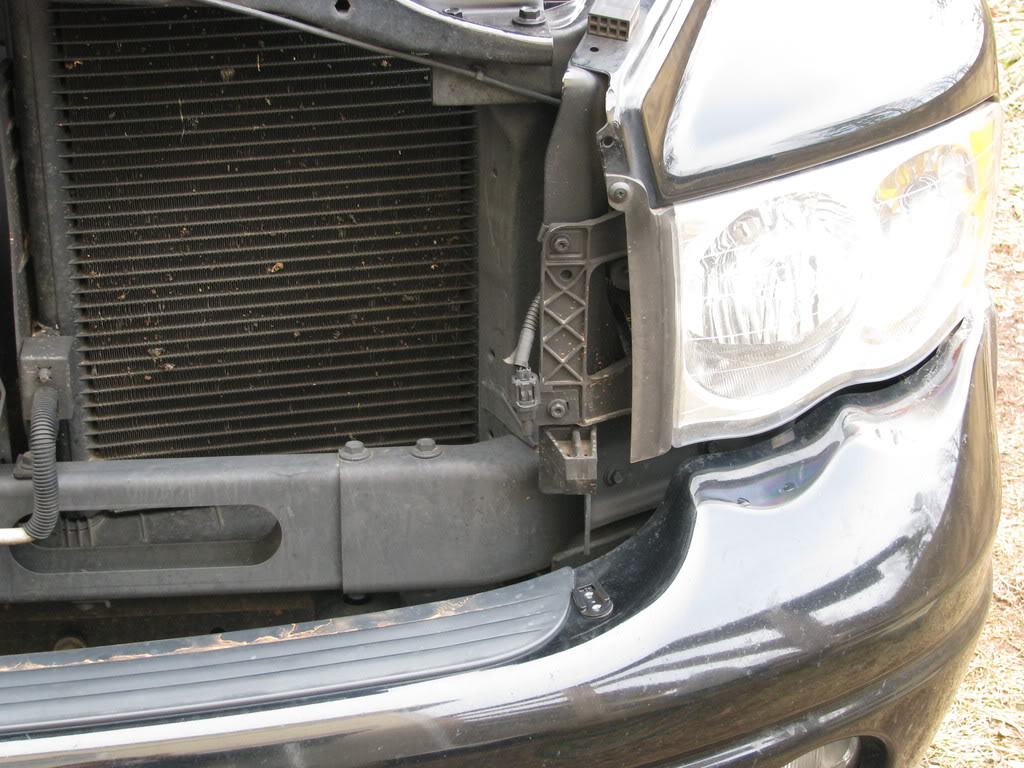

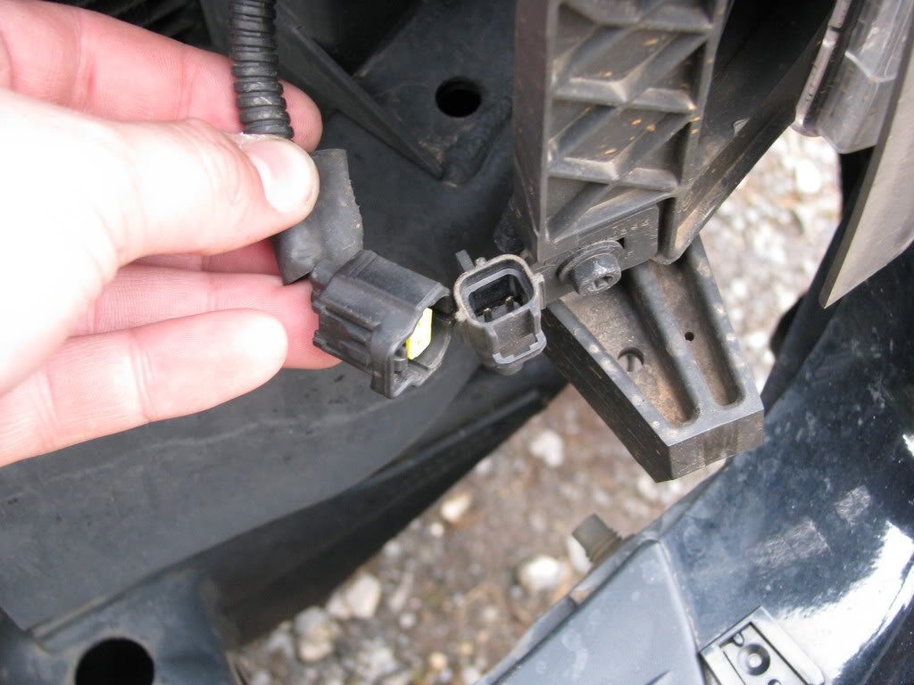

Befor you do all this, did you check the temp sensor connection? The temp sensor is at the front of the truck on the driverside behind the grill right next to the headlight. it is actually attached to one of the screws holding the headlight in.

wala...........you guys are awesome it works!! I've been searching for almost a month trying to decide if to get one from ebay or just til cant take any more. That didnt work frog I ate the chicken with the frog legs and rice lol

haha nice, yeah I went a year before finding this out accidentally. There wasnt much info on it here before then all of a sudden there were quite a few people with the problem.
