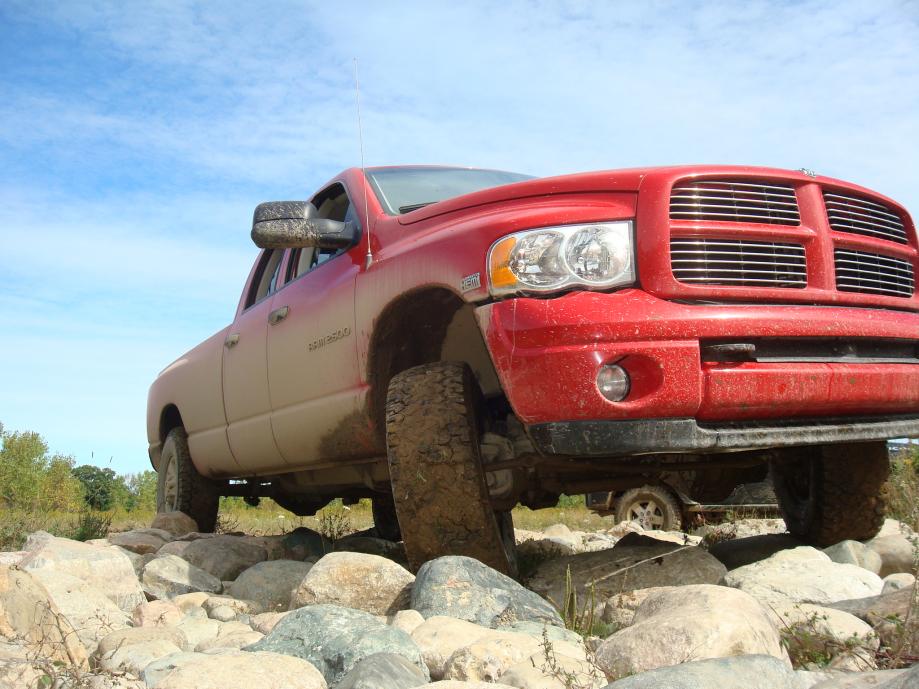

I have 315/75R17 BFG A/T's on mine. Haven't noticed much of a difference in on road performance. Doesn't get wheeled too often... a little large for tight trails. I believe I have 3.73 gears, I can check tomorrow at work.
