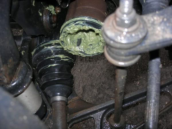

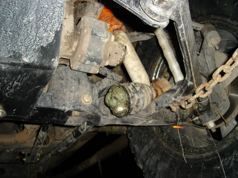

If you MUST run 37s then DO NOT run a 6" suspension kit to do it, YOUR CV ANGLES WILL BE TOO SEVERE. Instead run a combo 4" suspension lift and 3" of body lift as the body lift itself doesn't strain the suspension components.
The only people who should try to get away with 6" of suspension lift and 37" or taller tires on IFS trucks are either TOTAL pavement queens or those who know how to change a busted CV axle in the field.

So 35's with a 4" suspension lift is safe and I could run 37's if I did a 4" sus. lift and a 3" body lift but then I'd have to worry about the cv axles and ball joints and such still? Do you still not recommend this or is it the same stress on everything as the 35's? I'm not dead-set on the 37's, just like the amount of rubber showing with 20" rims.
The pics look like some nasty guacamole is in there lol.

I'm personally NOT a fan of 37s on IFS trucks, the front ends are just not made for it. It amazes me how many guys buy a 1500 series truck and then want to run 37, 38 or even 40" tires when they could have just bought a 2500 series SFA truck that's made to handle it!
If it's the MEAT of the tires you want, then run 35s on 17 or 18" wheels. That setup is INFINITELY MORE functional off-road than 20" wheels anyway. IMO 20" wheels are for looks, 17s are for function.
Again if you just HAVE TO RUN 37s then THE SAFEST way is on a 4" suspension/ 3" body lift combo, however the weight of the 20" wheels AND 37" tires will still put more stress on the front end than running 35s...
