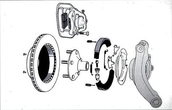

The parking brake on a disc brake setup usually is a drum brake. Just that the drum is actually the inside of the rotor.
