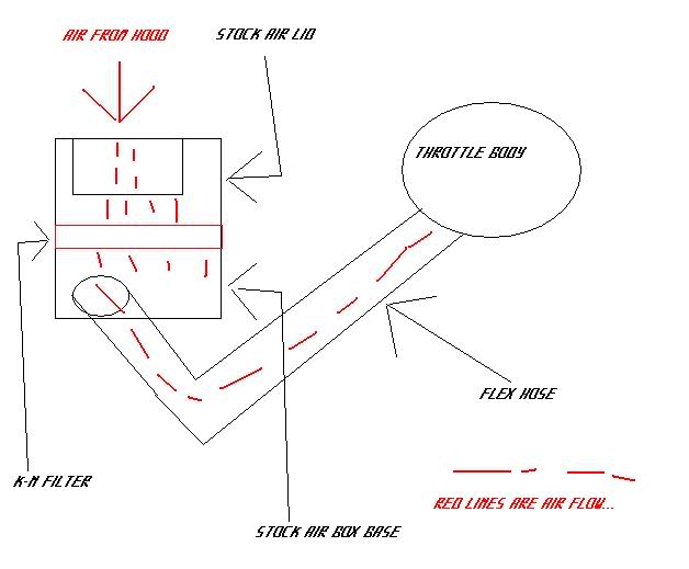

here ya go ramhunter...CAI box

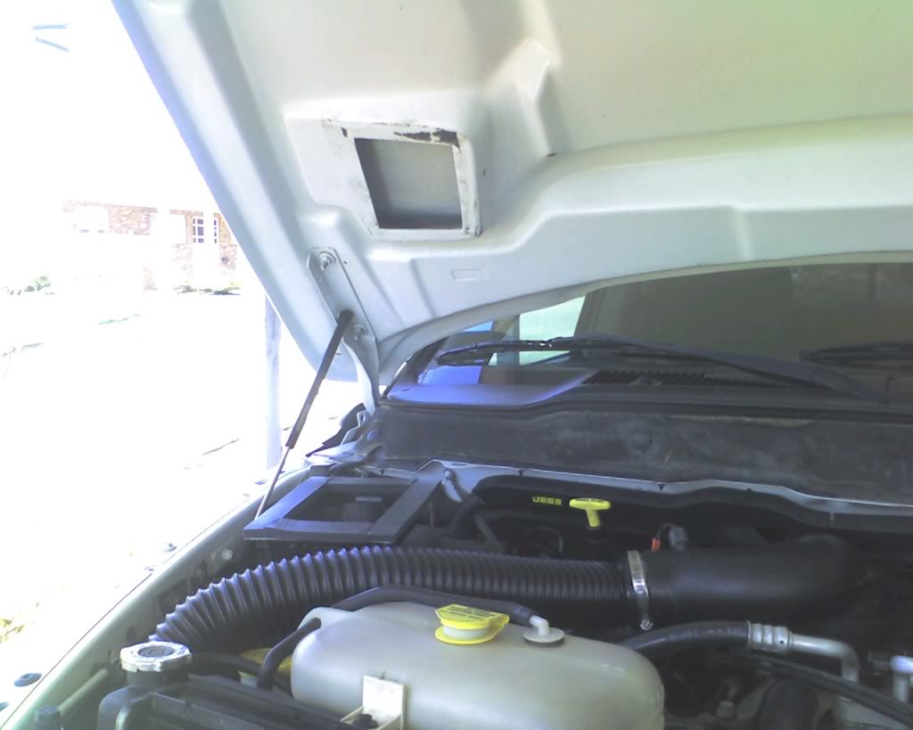

nim you got more pics im missing something...i assume you got it hooked to your hood somehow?....
Old Mar 29, 2010 | 01:23 PM
nim81's Avatar
nim81
Joined: Nov 2006
Posts: 2,400
From: fredericktown
when the hood closes, it seals up on the foam attached to the dryer vent

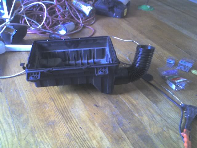

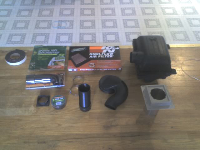

here some more pics

okay thats what i figured but wanted to make sure

Have you noticed any gains from that set up?

Bloody inventively ingenious ! If I ever get a ramair hood I'm going to have to fab up a custom intake like this.

Is there a scoop on the hood or something? Kind of cool...

a little more pep on the highway, nothing major
