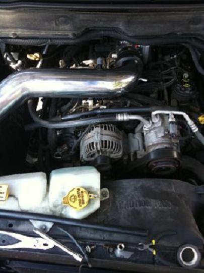

I picked up the Boomz Racing CAI for my truck after DF member jusjay727 recomended it. Though the kit said it was only for the 03-04 Ram HEMI, it installed with little issues. There were no instructions shipped with the kit, so I just had to wing it. About 4 hours total, and that includes extending sensor wires. I also installed my ported TB at the same time.
Here is the filter end

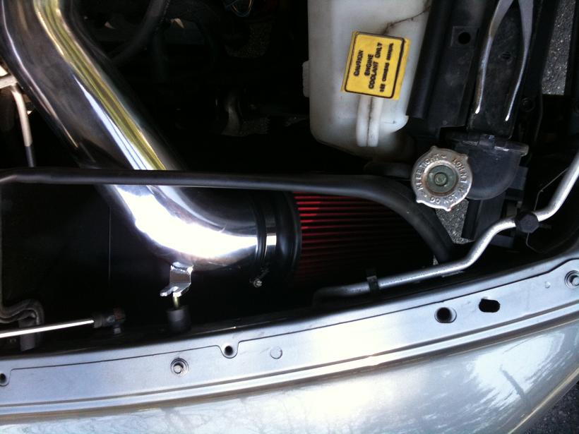

Here's the intake tube

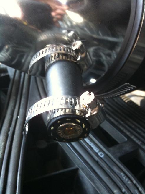

If you notice on the right side near the TB, you will see a little inlet tube. I wasn't sure what this was supposed to be for. At first I thought it might be for the oil breather, but then thinking about it, I wasn't sure that I'd want the oil breather that close to the TB. Also, there is a hole in the heat shield for what looks like the breather tube to go into.
Here's my solution for plugging up the extra tube.

Very nice. For the plug... I hope that's not a live round? I think I see hammer contact?..so that's a good sign
I believe that is what the diff. is with the years, your inlet pipe block because I don't have anything but the IAT sensor in mine.

You are correct, that is a spent 45ACP case! As a reloader, I have plenty laying around!

Nice Job, BTW the blocked off tube is for small hose that runs from the Hemi Hat to the oil cap on the 03 model (3 inch long and $25 bucks at the dealer). I tried a dual Bombz and found zero difference so went back to stock set-up. With all do respect though "Wow" how does a TB get that dirty. The new ported one sounds like a noticable mod difference (I like 4k and up) and I have been thinking about getting one but CAI and new hood is ahead on the wishing list. Good pics man.

Thanks for the comments. On the 05 the oil breather runs all the way to the air box, so that would make sense. Yes, the TB was not just dirty, the back side of it felt like 50 grit sand paper. I can see how that would cause a performance drain on these engines. I'm going to put the TB cleaning into my regular maintenance schedule going forward.
