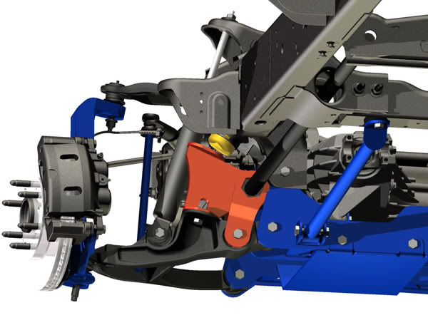

I have a 4" lift similar to the rough country lift. It has the torsion bar drop.
This drop sucks for clearance. Is there any way I can get rid of this drop with out getting a different lift kit?

I agree, the torsion bar drop looks like ***... i know theres at least one lift that doesnt have the drop but it aint cheap.. they use brackets on the a-arms that move the part that attatches to the a-arm up, that way the t-bar is still at a factory angle... i'll see if i can find a pic

here, its on a cheby but is still the same general idea... i wouldnt doubt that you could fab something like this up if you know what you're doing...
this is a rough country lift... i know i've seen a similar setup for the ram from a different company but cant remember where

Thanks for the info, I have some welding buddies, I'll see if they can fab some thing up.

BDS suspension is the only one that does that for dodge. I would get a hold of BDS and see if they could explain it to you, even see if maybe they could make just that part of the kit for you. Im sure it will still be somewhat pricey though.

http://www.bds-suspension.com/php/Kit_Link.php?kri=620H
There is the link to the kit.
