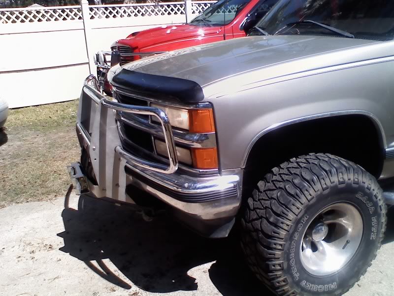

For a nice aggressive 33" M/T tire you may want to look at Mickey Thompson MTZs (they are available in 35" also). Here is a set on a buddy's Z71 I had just sandblasted his grill guard uprights and color match painted them, the chrome had been peeling off and they were rusting for a couple years now. These MTZs were purchased by him in '05 and have about 60k miles on them, so you'll have to go to the Mickey Thompson website to see them with a full tread:

He has a 3" body lift and 2" of suspension lift and it looks great with those 33's on it. Although Cheby's are different and he can't fit 35s without at least 6" of lift...

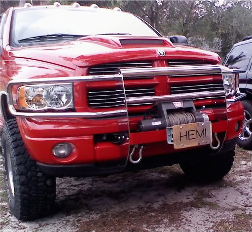

The FCII is louder than most A/Ts, but not as loud as most M/Ts. I currently have about 30k miles on mine and have about 90% tread on them. Here's a fairly recent pic:
If you can afford it, get you a set of Mickey's or Cepek's, they are flat out performing tires and last forever! If they are a little high for you, look at either Nitto Trail Grapplers or Toyo Open Country M/Ts. For a little less aggressiveness and a quieter tire it's tough to beat Mickey Thompson ATZs (Bear has a set that he just cannot wear out no matter how hard he tries) or Nitto Terra Grapplers...
