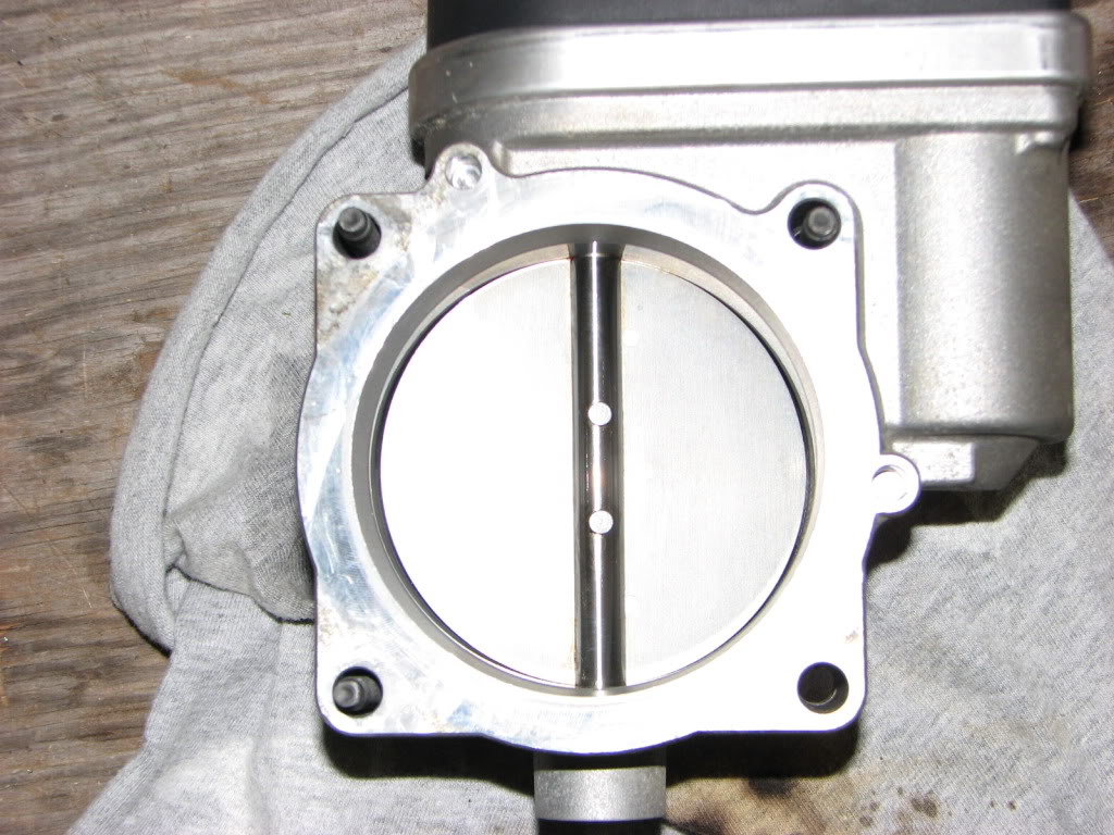

First was the throttle body cleaning:
Before:
After:

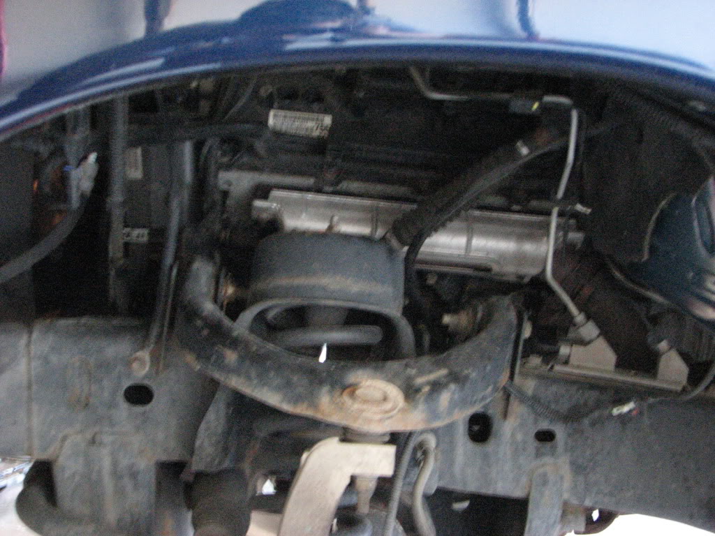

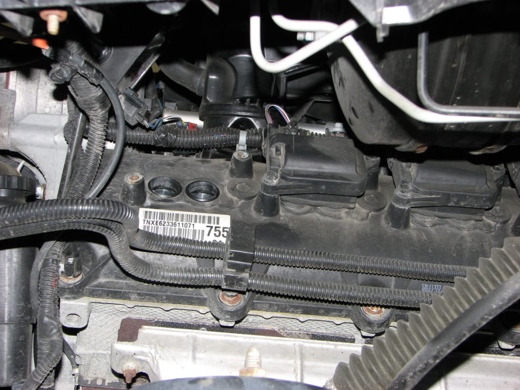

After the throttle body cleaning, I got the plugs changed. To make things easier on myself, I went through the wheel wells.
All in all it wasn't that bad. It was time consuming mostly due to the fact that this was my first go around with plugs on the HEMI and I wanted to make sure that I took my time and got everything right. The KD plug sockets worked like a champ. The medium length was just the right length to clear the neighboring coil pack, and I had no trouble getting to the back two cyl on the driver side. I only had to use my flex head socket on the far back cly on the drivers side, no U-Joints were needed throughout the entire change.

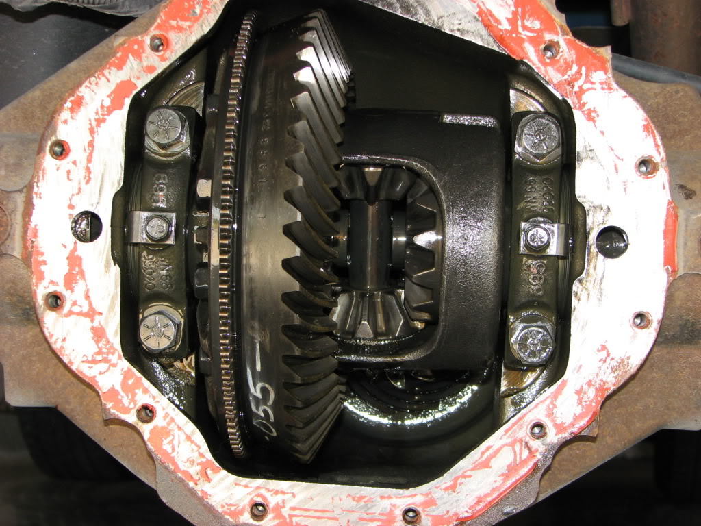

All went smooth with the fluid swaps. No surprises when opening the rear diff. Minimal metal sludge and no flakes chips or retainer clips.

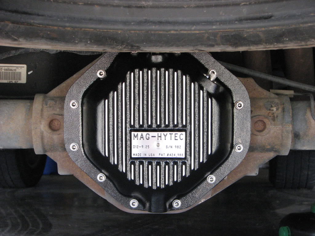

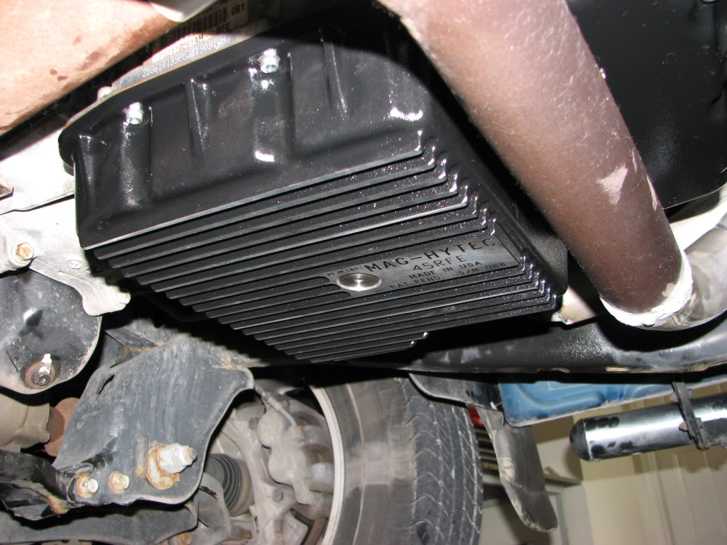

During the fluid swaps I installed my Mag-Hytec diff cover and trans pan, and they are very nice, high quality parts.
Diff Cover:
Trans Pan:

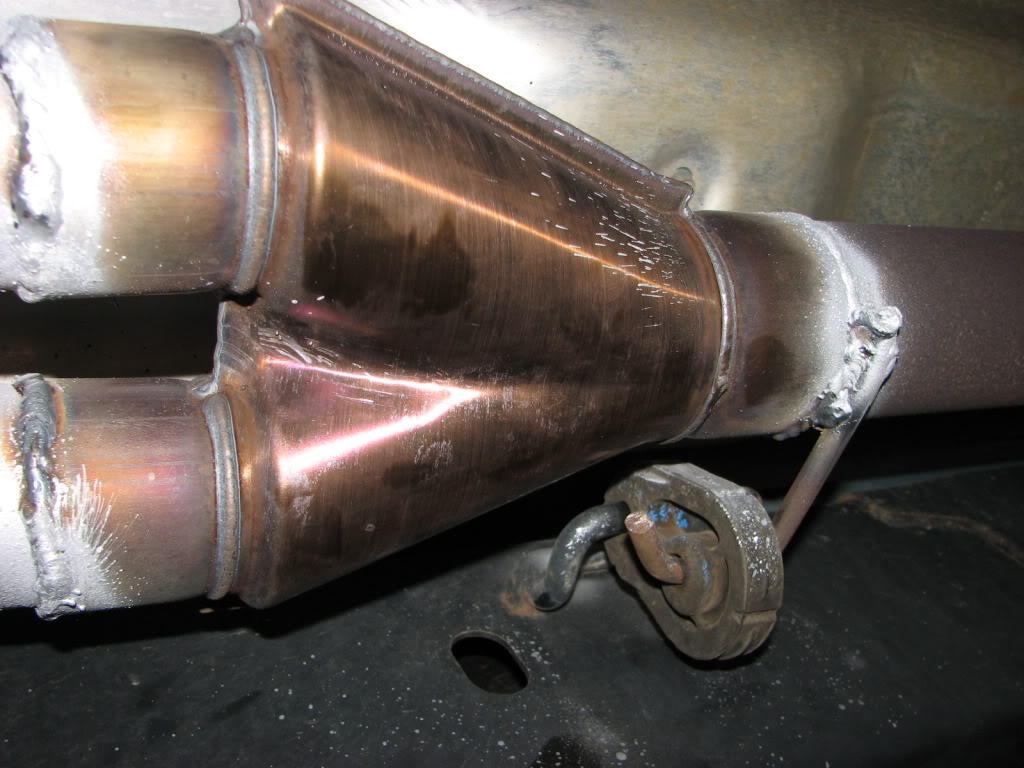

While I was under the truck, I decided to snap a quick pic of my Magnaflow Y pipe too.
