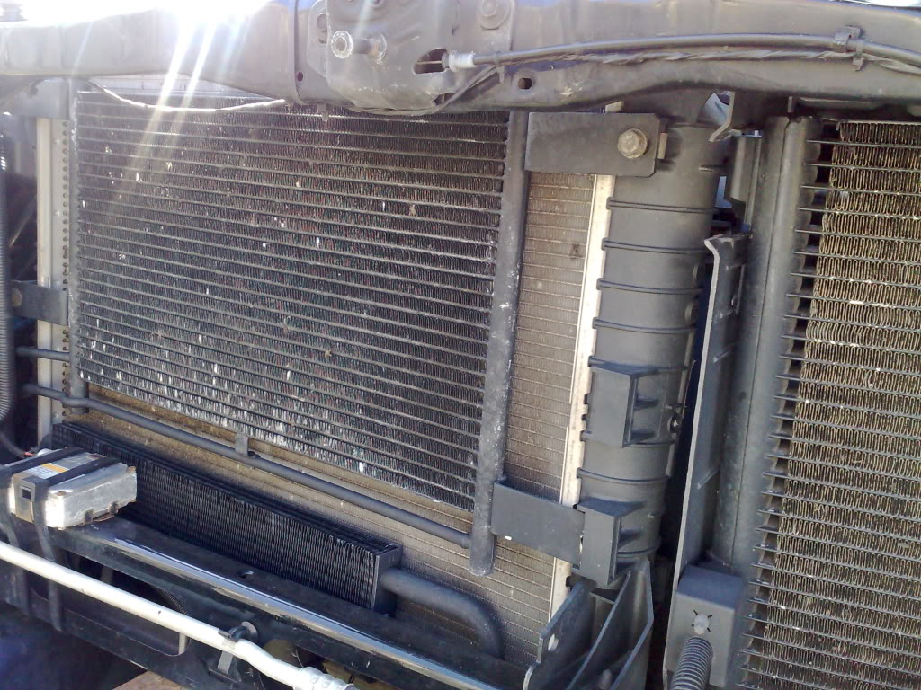

There are lots of different "stock" coolers. That's half the confusion.
This is the stock cooler on my truck. I've never bothered to count the rows because it keeps my trans plenty cool (as measured with a gauge) when towing my heavy boat.

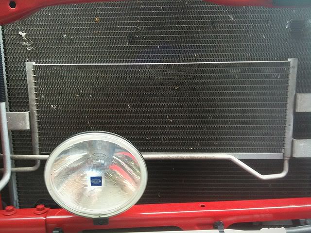

Here's my 26 row stock tranny cooler.
I guess we 03's have crappy PCM's but good cooling lol.
To the OP.......Yep your tranny needs to get up to temp, just so the OD can kick in.
I figure you need the performance of the 26 row cooler max, as this is what Dodge fits.
Hey Frog....looking at your pic........where's your PS cooler?
Al.

Hidden by the camera angle.
