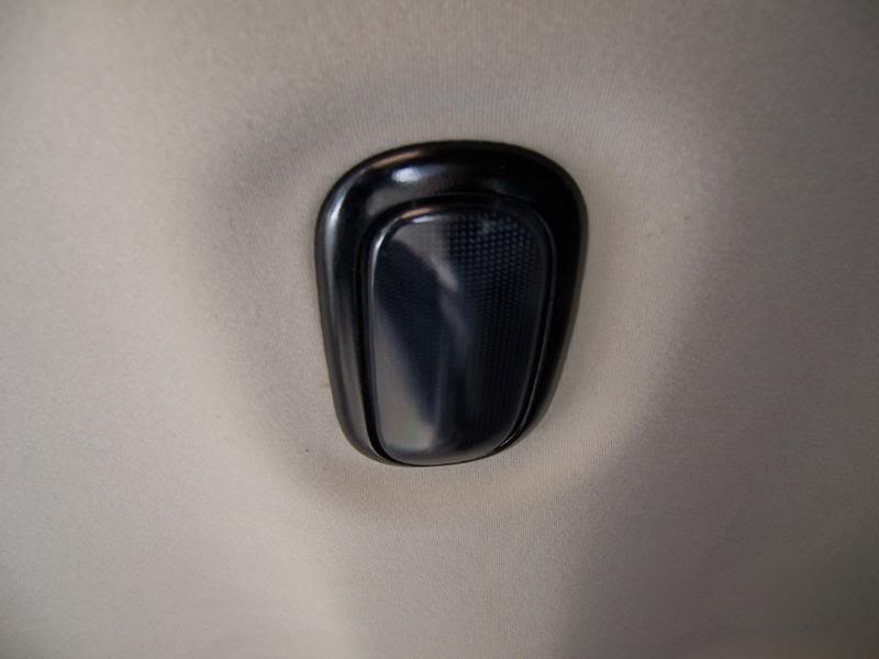

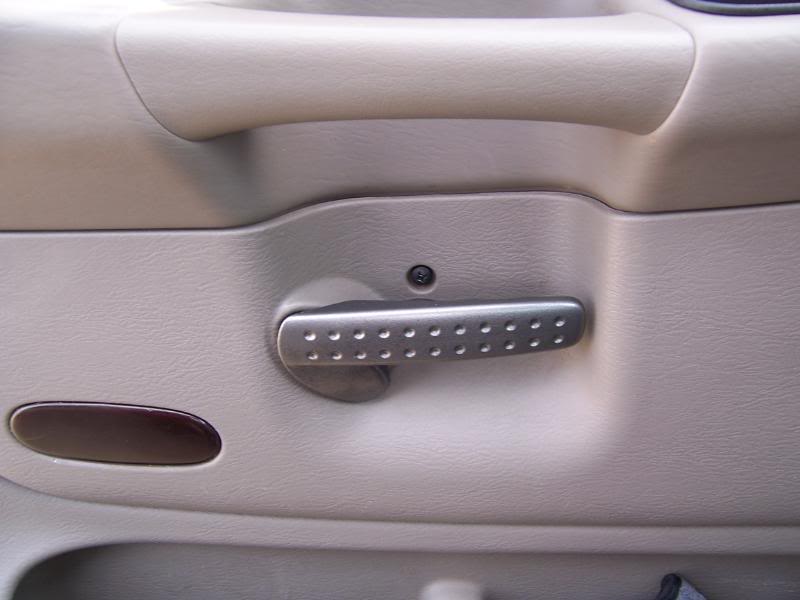

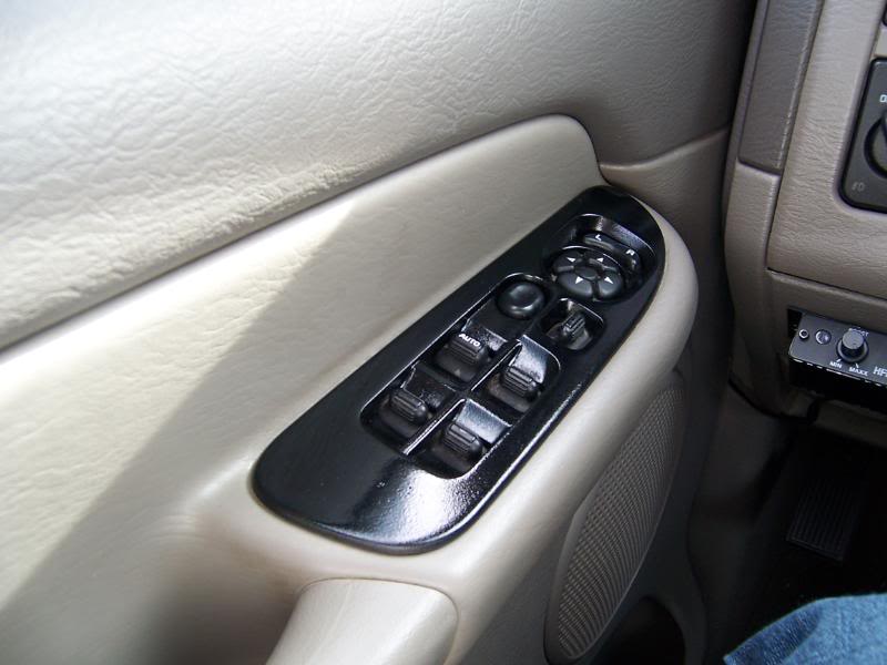

Here u go
All this was really easy to paint. I am going to paint the accents on the door panels sometime this year the speaker is going to b black witha silver ring.

what kind of prep work was used?
looks like the bezel wouldnt stick very well.. aka hard to sand inside the little holes.

Everything pops out a different way but its pretty easy.
If i was to do it again
Clean
Sand
Filler Primer
Etching Primer
Paint
Clear
BAM!

Etching primer is for metal, and if you paint plastic you want to use a good adhesion promoter (bullydog), which could take the place of primer unless you leave some sanding marks, which could be filled with the filler primer
And remember plastic parts are made in a mold. They have a mold release agent that is on the outside, so its always a good idea to rub it with a wax/grease remover (or even better, a mold release remover)

Yeah my driver side control panel is busted as well.
Just take your time and dont break anything. My friend wast trying to go to fast and he broke his dome light lol.
The door switches just pop up
the overhead console has 2 screws under the light bulbs i think?
and the dome light pops open from one side.
The center console is pretty easy i just taped off the parts i didnt want to paint.
