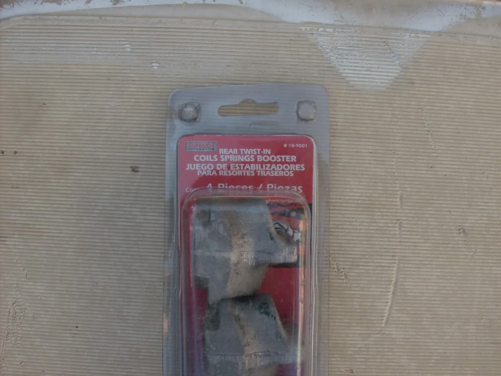

For a 1" 1/2 spacer i just bought spring helpers at my local auto parts store i think it was pep-boys they had rubber ones that were round like the spring or this
They almost gave me 2" in the front still want to buy the leveling kit thow here is the before and you can see the after in my signature
