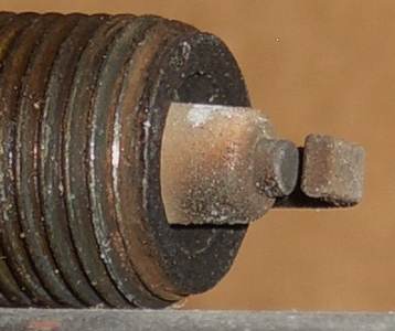

Here is a pic of plug colours, half the cylinders are the whiter colour, half are the brown colour, if they all varied a bit I wouldn't think anything of it but they are all exactly one or the other.
Which cylinders shut down with the MDS?
Any ideas appreciated.

The brown plug seems to indicate a correct mix and a good working engine.
The white plugs.....well they almost look like they are unused??
We really need a decent set of close up
pics looking "end on" to the plug and a side view.
Try using your camera on macro mode to get these close ups.
There's a lot you can tell about engine efficiency from spark plug colour and condition.

Here are better photos, previous was taken on my phone.
Thanks

Well from what they look like, they're OK apart from some normal wear.
Here's a colour chart for you to look at.
http://www.dansmc.com/spark_plugs/sp...s_catalog.html
And a good article to read plugs a bit more in depth.
http://www.4secondsflat.com/Spark_plug_reading.html
Al.
