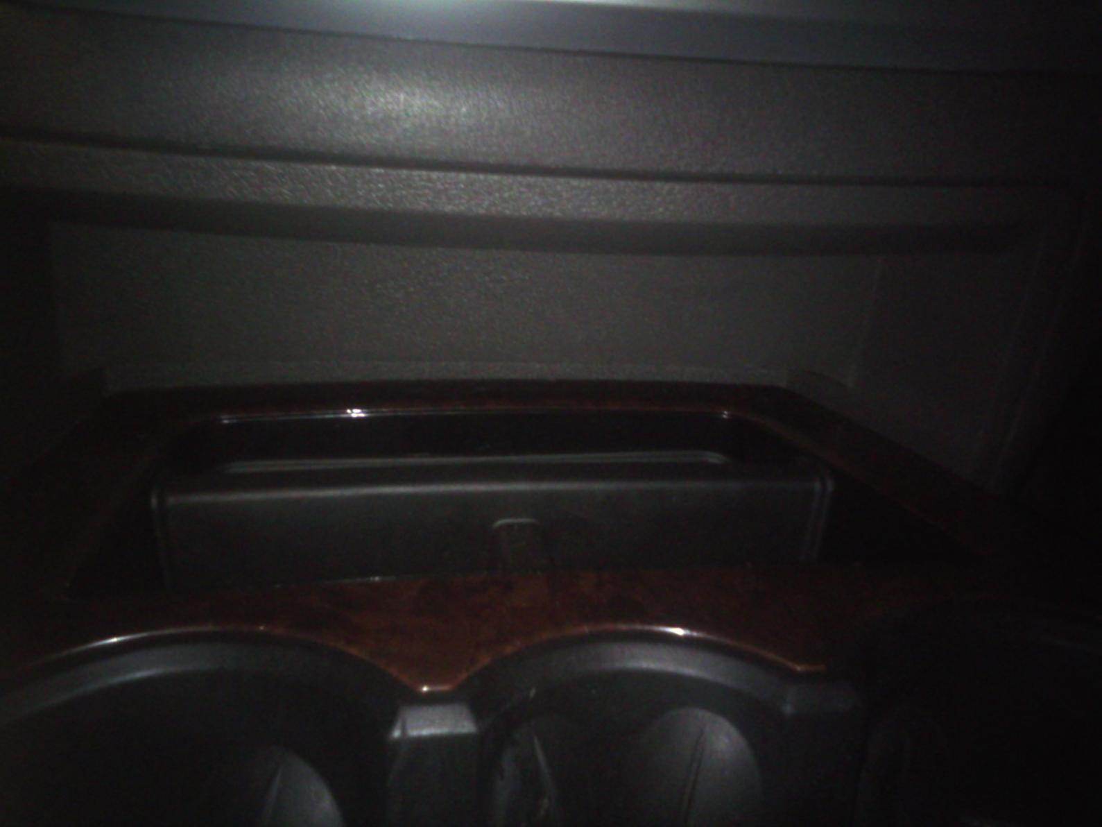

Hey all need help removing the lower dash panel in a 08 ram 2500. the panel i need to remove sits just above the cupholder and below the fake wood panel. it holds a light in it and nothing else. be posting photo in a few

hope it works this time

Not sure if my 06 is the same but if its the small courtesy light for the cupholders, which are on the floor in mine. You have to start at the cupholders. remove the rubber cupholders. They just pull out and there are screws underneath. Remove the boot around the 4x4 shifter if yours has it and work your way up to the panel with the light. My light was burnt out. Takes 20 minutes to take apart for a bulb that cost a buck. Dodge engineers at work.
