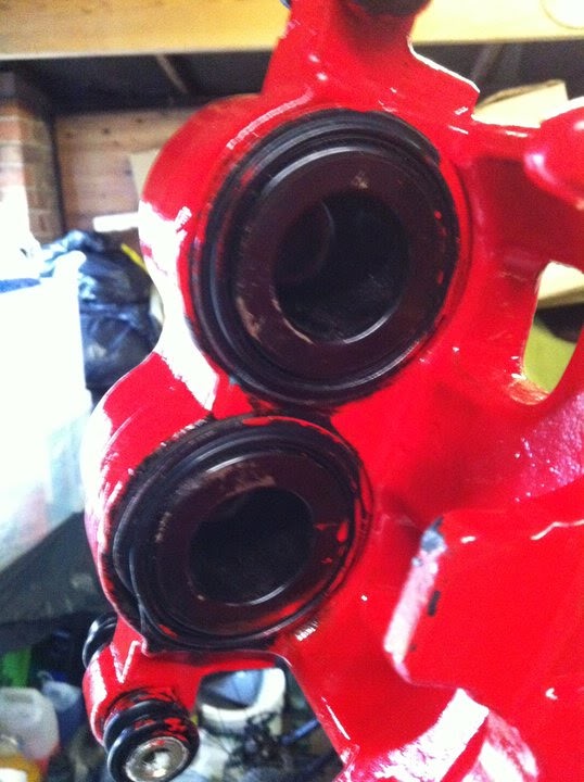

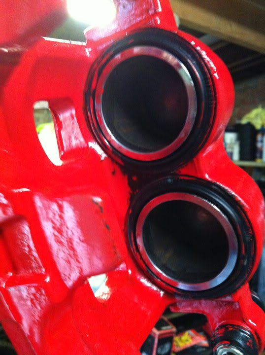

Now when I get around to painting them back home to fit on my truck.....I find one front caliper has what appears to be steel pistons and the other that plastic stuff/phenolic pistons.
My question is......can I install one streel caliper on one front side of my truck and the other plastic piston caliper on the other?
They are both brand new units.
The first pic is the steel unit and the second the plastic.
Al.

See this on the other site this morning but I dont think you will have any issues using it. They would not have made it that was if it was going to be a problem IMO.

No issues with performance. Phenolic pistons were used to prevent corrosion and thought to last longer then steel. Problem was, they chipped and broke from age and being pushed back in with large pliars.....
