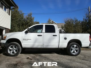

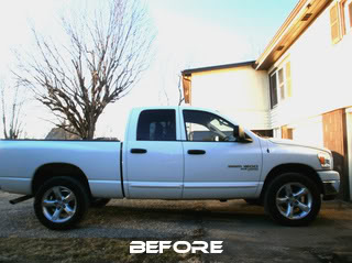

I was told on my '06 that 2 1/2" spacers would make my truck dead level, but the drawback was as the rear starts to "settle" it would give me the "sinking ship" look. So I opted for the 2" leveling kit which left my truck 1/2" lower in the front than in the back. Which is kinda nice because if you haul anything in the bed it levels it out and you still have the level look.
