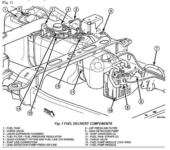

Old Apr 28, 2011 | 06:48 PM
HammerZ71's Avatar
HammerZ71
Posts: 24,686
In response to your PM:
Old Apr 29, 2011 | 10:11 PM
Magnum4406's Avatar
Magnum4406
Joined: Mar 2011
Posts: 101
From: Michigan
Check the rubber hoses going to and from the evap canister. I have seen a few that split at the fitting and will throw a large evap leak code.
