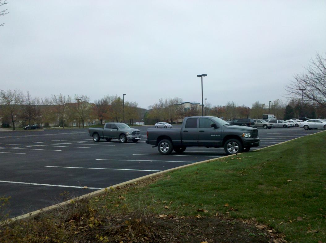

Kind of an odd question here, but when I bought my 2004 Dodge Ram 1500 4x4 hemi back in 2007 it only had 20k miles on it. I bought the truck and later noticed that the drivers side front was lower (had less wheel well showing) than the passenger side. I had a warranty on it so I took it back to the dealer and they asked me if the truck had ever been in an accident. I said, I hope not because I just bought it here a couple of weeks ago and they said it was accident free.
Basically, they said someone had messed with the "ride height adjustment" and they generally only see if that it was involved in an accident. They corrected the driver's side and now my truck is pretty level. I'm wondering if they did a torsion bar crank on this thing, or is there some other "ride height adjustment"?
Attaching a picture, my truck is closest in the picture and you can see a newer Dodge Ram in the background with the standard factory rake. You can really tell a difference. Both are 4x4's, and not sure what year the newer Ram is.

They cranked the key bolts...

Thanks for the response Hammer. Having lurked on the forums quite a while now, that was the only logical explanation and it looked like the truck had been 'leveled' as I don't see that 'factory rake' others describe. Either way, I'm certainly glad the dealer cranked up to match the other side and not down. Yeah, I wonder how the passenger side got cranked up, but who knows... I guess who cares as well, I currently have 82k on this truck and haven't had a major issue yet. Still loving the hemi power.
