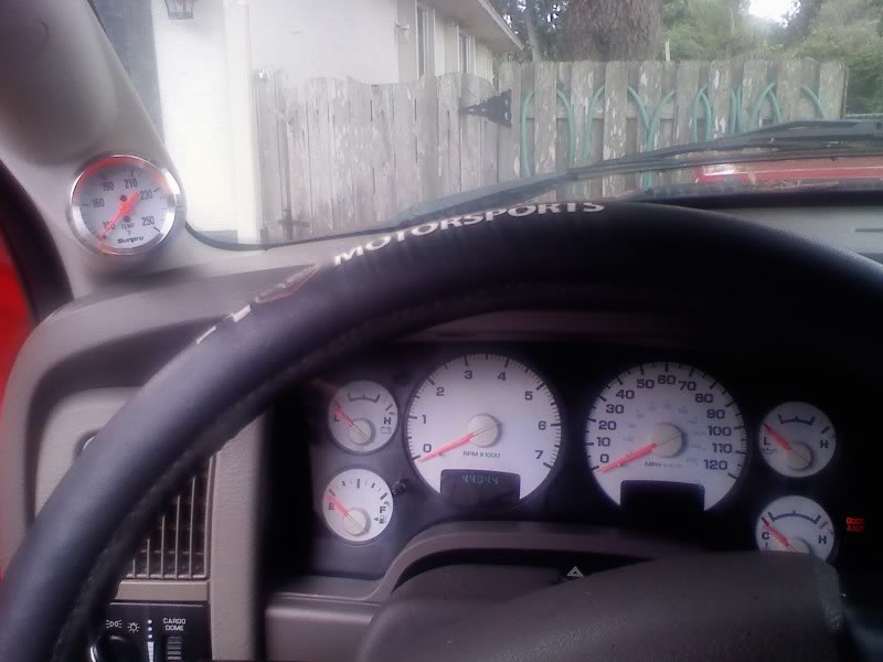

I bought an SRT A-pillar from the dealer for I wanna say it was around $35 (but I usually get things for a little over cost - so I dunno what retail is), bought just a cheap temp gauge at Advance for like $16 (which matches the stock gauges about as close as you can get) and simply tapped the test port on the pan.
Now I'll agree with NV290 that the best place to measure would be right at the cooler line rather than the fluid in the pan, but there's not gonna be a big difference and I had what I needed to thread the pan and didn't have to buy anything.
