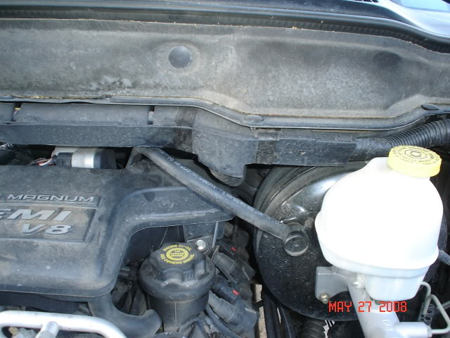

OK, but if I get this right, you owe me a six pack of beer.
You may have lost vacuum. I had this one on a Ram owned by a young lady that I fixed about three or four years ago (and I got a LOT more than a six pack of beer out of it, LOL).
Check this line:

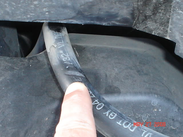

Look for either a hole or even a kink in the hose and also make sure to check the ends for tight fit too.
In this particular case, it was crimped and the cruise worked very intermittently, more often it didn't.
